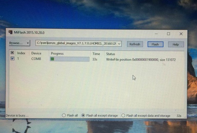

    So after asking for help on the Miui forum and getting little or no help i figure i'll ask here
    What happened:
    • Flashed a bad rom with Miflash in Qualcomm EDL 9008 mode.
    • View bad flash log here (remove "DOT") ---> pastebin DOT com/raw/jeU6eXsf
    Phone state now:
    Phone tries to boot, displayed Mi splash image once, then mi boot image briefly, then turns off.
    • Recovery is corrupt, does not boot.
    • Fastboot boots, but it is locked (thanks xiaomi) and of course miunlock does not work

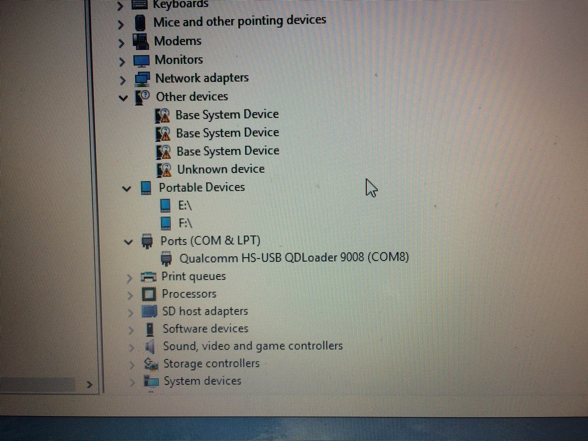

    • If connected to the PC while "off" it shows up as "qualcomm HS-USB Diagnostics 900e" in device manager, drivers were installed from miflash folder, so they are correct.
    I have tried various button combinations to make it boot back into Qualcomm EDL 9008 mode, but none work.
    Does anybody know what i can do to recover this phone?
    Regards.

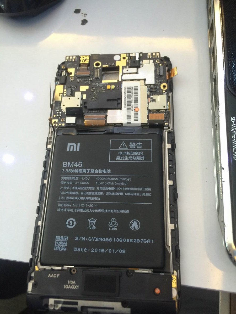

    i can help you
    I was successful enter download mode xiaomi redmni note 3 pro by hardware.
    If you need help contact me, inbox

    There is only one way to do it? By opening the back of phone??

    Yes, so that one on video.. if you press power + vol up , for some time you can do all as the video..
    And if you press power + volume down you can enter is fastboot.
    If you press 3 button you can power off the phone

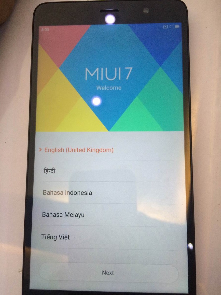

    yes I fixed it

    You need to download a fastboot reboot edl. Reboot to edl Command, flash a Fastboot official rom. The guide is there in en.miui.com

    I have same situation too, how to fixed it. Entering fastboot and run edl.cmd to enter edl mode. Flashed global stable rom still no luck, in my case i updated 6.8.18 developer rom via updater, and now stuck in twice flash mi logo when power up.
    Nb : My kenzo has ubl(unofficial),rooted,twrp but after update they are gone
    edited : solved with flash china stable rom
