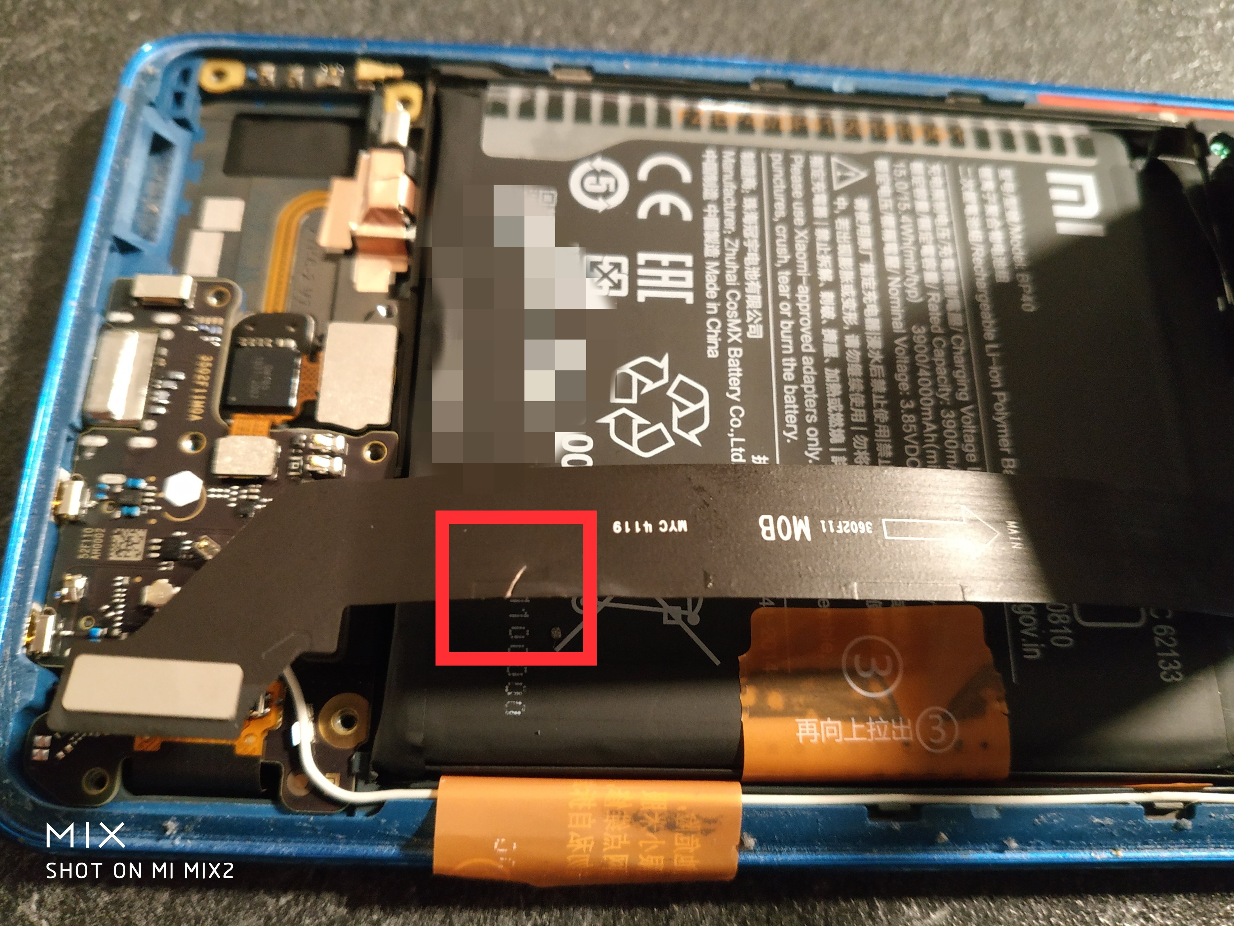

My daughter (1,75) got her hands on my phone some weeks ago and dropped it. One of the edges on the back cracked, leaving some sharp edges. To avoid injuries, especially for her, I decided to fix the battery cover. Unfortunately I cut the broad flat wire on top of the battery (see picture attached). Now the display won't turn on, but the phone ist booting and the screen ist still recognizing touches.
Is it somehow possible to order that cable somewhere?

Edit: found it in eBay. Will update thread after trying to fix it.
And, as a sidenote to all trying to remove the back cover: Just slide around the edges. Do not cut too deep into the middle.
Or do it if you like fixing things as much as I do..
¯\_(ツ)_/¯
Final edit:
Got the spare part today. Had to unscrew the modules over and under the battery on the back to remove and replace the cable. Now writing from my 9t pro. Worked Just fine. Bought the cable via eBay. Description said LCD cable but it worked anyways. Thread can be closed. Maybe it will help someone else one day. ^^
