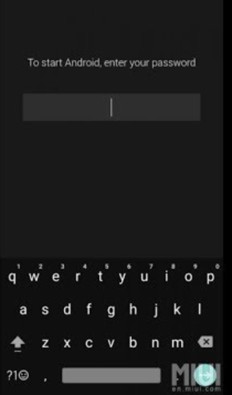

I tried to install TWRP many times, formatted the phone about 6 times. This happens after "fastboot boot twrp.img". Every time I tried, I got this error. I tried my password on the lock screen, searched for interned passwords (default_password and password did not work), Google password, last time set the encryption password as the password on the lock screen and still did not work. I would like to receive your help, ready to give some information. I unlocked my bootloader and every time I turned on USB debugging after formatting. So I could not launch TWRP I guess.

I can't launch TWRP I guess, it requires PIN as I said after boot. Actions before are the same I made all these times.
When TWRP asks for PIN press cancel...then FORMAT Data..

There is an interface like this one (image taken from the internet), I haven't seen cancel there.

tape this into fastboot: fastboot -w it will erase everything so we will not ask you any more code .

OK, i made it. Thanks everyone for help. I just didn't know how to enter TWRP.

After fastboot flash recovery twrp.img I didn't use fastboot boot twrp.img, just entered recovery. I guess the problem was that I didn't know that TWRP launches as a recovery.
