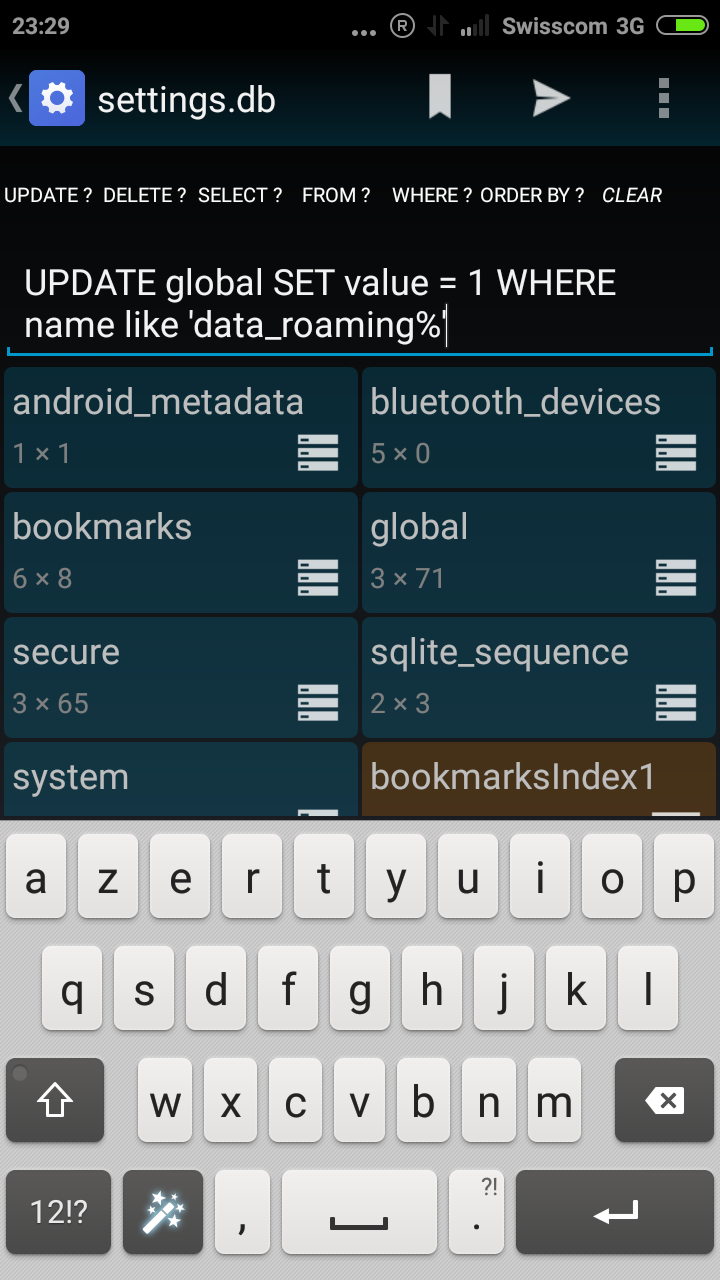

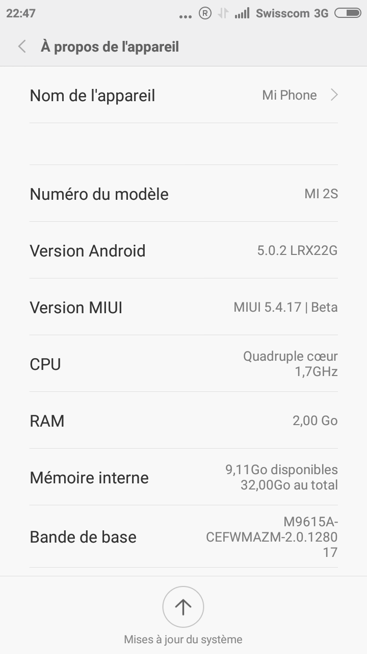

I just found a workaround for mobile data while roaming! It should work on all lollipop versions for MI2(s).
To enable data while roaming open the file:
Code:
/data/data/com.android.providers.settings/databases/settings.db
as root with your favourite sqlite editor (I use SQLite Debugger, which works fine) and update the values of every row which contains "data_roaming" in the table global to 1.
You can do this with the following command:
Code:
UPDATE global SET value = 1 WHERE name like 'data_roaming%'
Do not forget to commit the changes if you use SQLite Debugger and then reboot your phone. If this doesn't work, try to switch data off and on again.
If you want to disable data while roaming you can use the following command:
Code:
UPDATE global SET value = 0 WHERE name like 'data_roaming%'

OMG you saved my day!! I have been looking for a solution for this for a long time and this works. Then I`m back on Lollipop :)
