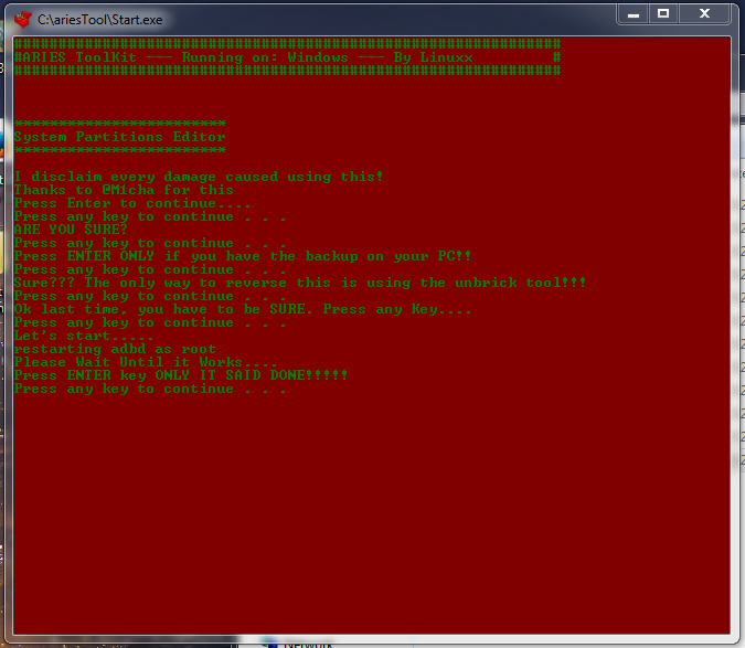

Try Aries Toolkit I've added this Now, so you can use this without need adb and co.... This is automated, let i upload it ;)

Does your Ariestool only work for Miui? Eventually I continued, my phone rebooted into CWM and nothing happened. I didn't even lose my data...

Fixed, found it on mega, same directory
I've tried it again, but I doubt it worked.
1) Booted into CWM
2) Ariestool -> advanced -> extend partition -> followed instructions
3) Phone automatically rebooted intro CWM
4) I'm still able to boot builds that were installed before, I thought they should be gone?
So how can I check if it worked or not?
