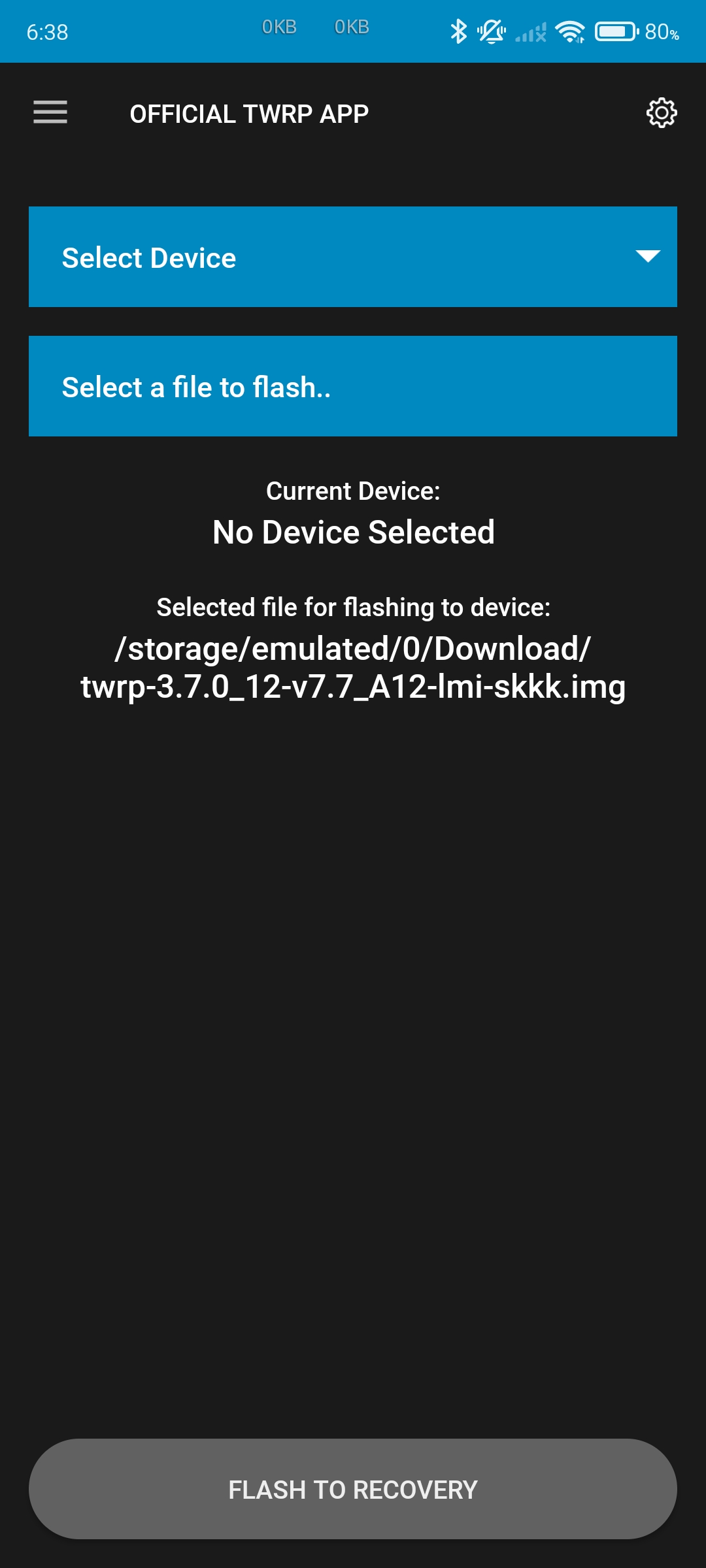

Cheers, but you say update twrp in it.. You mean in the TWRP app itself? (I don't have it installed) so download the image and run it through the app?
Update* ok, through the official app with the downloaded img...I presume that even if the poco f2 Pro/k30pro is not in the list of devices I can just select any device and select the side loaded img and flash?
