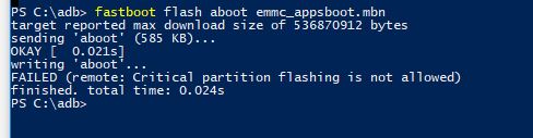

C:\Users\Carmelo>fastboot flash aboot emmc_appsboot.mbn
target reported max download size of 536870912 bytes
sending 'aboot' (585 KB)...
OKAY [ 0.021s]
writing 'aboot'...
FAILED (remote: Critical partition flashing is not allowed)
finished. total time: 0.024s
C:\Users\Carmelo>fastboot flash abootbak emmc_appsboot.mbn
sending 'abootbak' (585 KB)...
OKAY [ 0.021s]
writing 'abootbak'...
FAILED (remote: Partition flashing is not allowed)
ok guys i solved, i simply used the mi unlock tool and in some seconds i unlocked the phone and then started correctly :)
