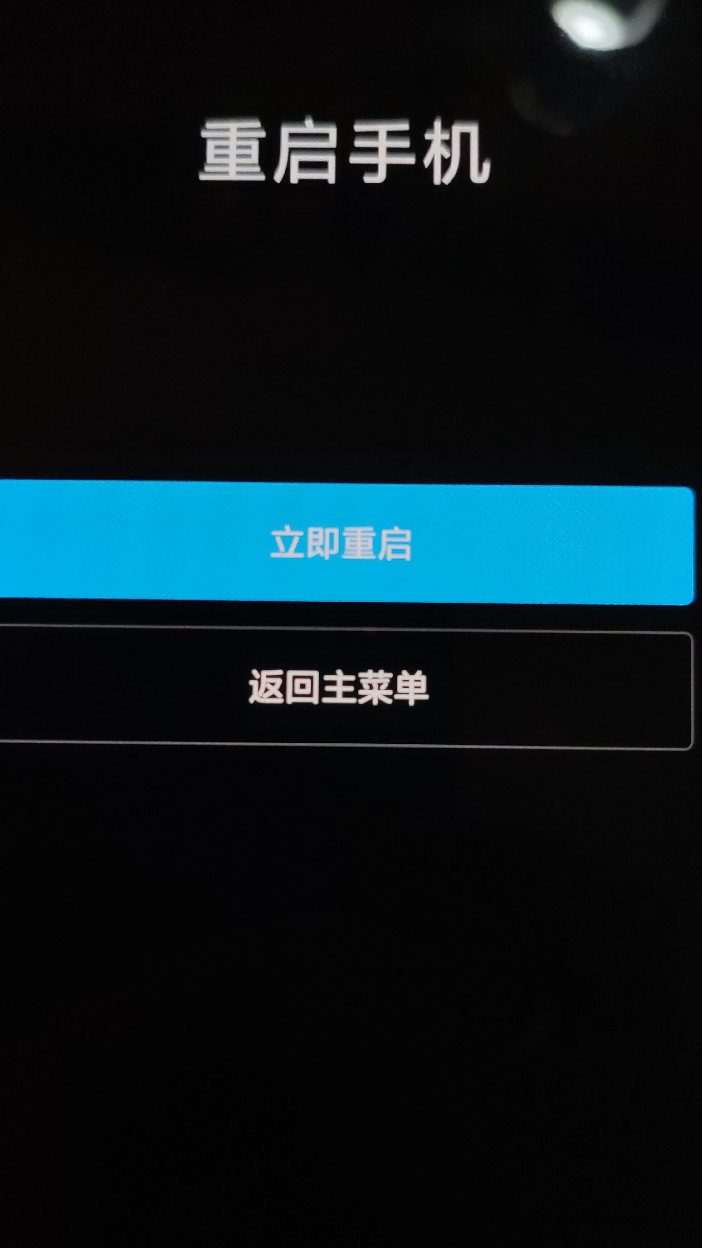

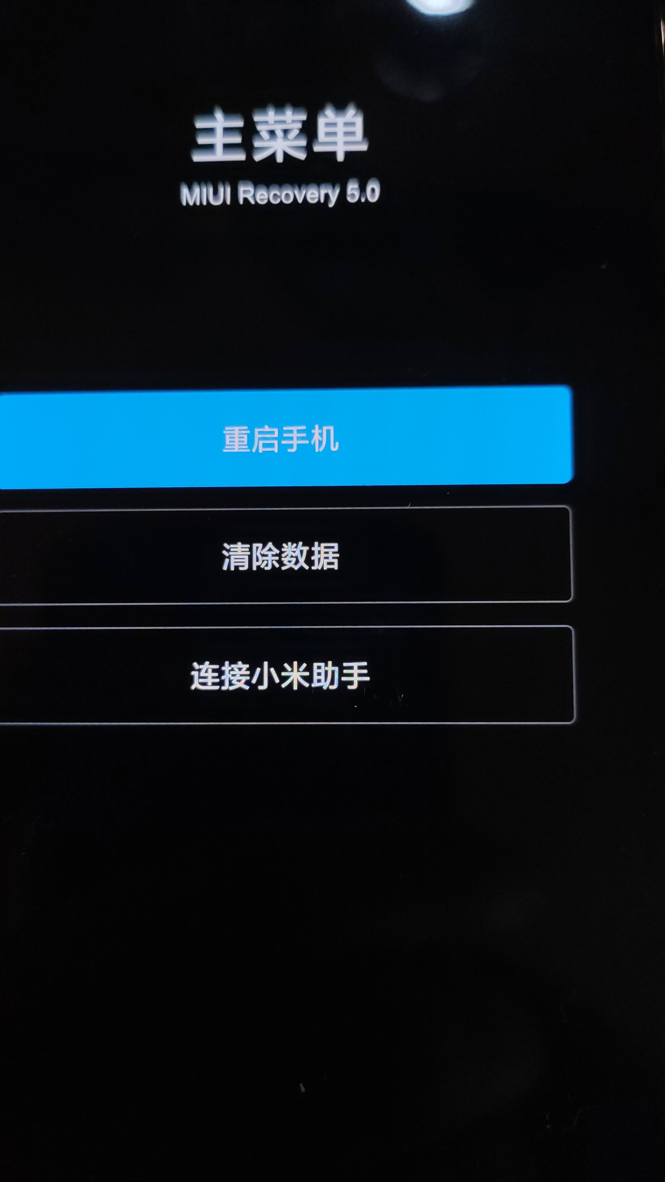

Now I like update to 12.5.20 and downloaded file into mi11. pressed "install" and have to wait 5 sec the said "no response (wait/OK)"; said "wait", get immediate info about encryption, Said OK; get continue? recovery 12.5.20 and with no data erased said OK. - nothing happend. So tried buttom power on/off + volumen up, on reboot released power. CHinesee occure (expected TWRP -but non- see attached picture. no selection started recovery.
You have to run ex: fastboot boot twrp.img, again, twrp was erased when you flashed phone in fastboot.
