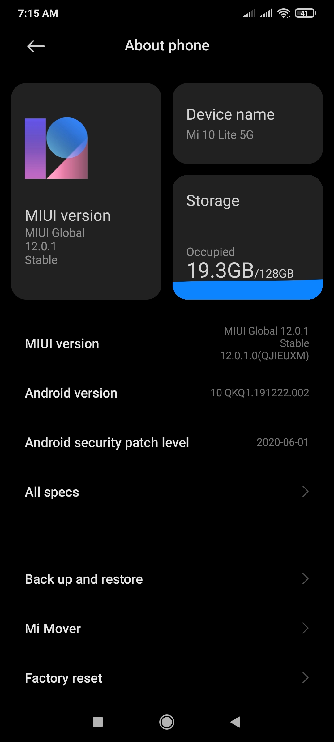

Before the update where you qjimixm or qjieuxm ? Because if you where qjimixm and you installed the update I will do so almost right away loll
could you share more info i cant have it to flash !!Was on mi, downloaded the EU firmware https://xiaomifirmwareupdater.com/miui/monet/ and through miflash I asked
Installed 11 and the update came
I downloaded the firmware, unpacked it to disk C. Downloaded miflash_pro_en_3.3.305.45_setup. You put the phone into Fastboot Mode. In the program, select the miflash mode, specify the path to the firmware and press refrash and a line with your phone will appear, you press to flash and that's it. Do not forget to install clean all below, save the data, otherwise you will losecould you share more info i cant have it to flash !!
Thank you very much last question are you bootloader unlocked ? Because seems like mine the timer restarted for an other 7 days btw the kernel is out so soon enough xiaomi.eu will arrive !!I downloaded the firmware, unpacked it to disk C. Downloaded miflash_pro_en_3.3.305.45_setup. You put the phone into Fastboot Mode. In the program, select the miflash mode, specify the path to the firmware and press refrash and a line with your phone will appear, you press to flash and that's it. Do not forget to install clean all below, save the data, otherwise you will lose
My bootloader is unlocked. TWRP would have issued an officialThank you very much last question are you bootloader unlocked ? Because seems like mine the timer restarted for an other 7 days btw the kernel is out so soon enough xiaomi.eu will arrive !!
