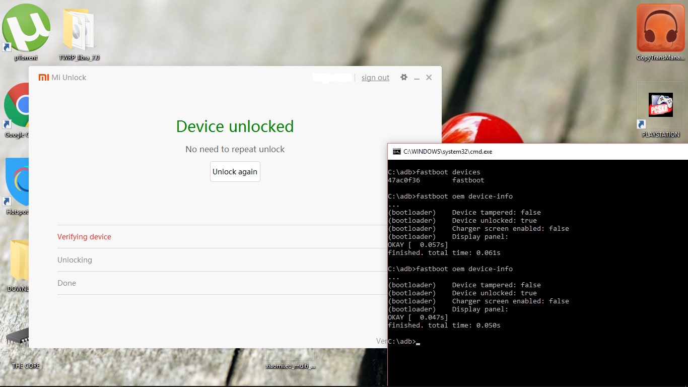

Phone was originally on some stupid global stable and changed to an offical stable (8.3.1).
After realizing that I should've swum towards xiaomi.eu stables I unlocked the bootloader via their stupid offical website.
I believe I just managed to flash the latest TWRP 3.1.1-1-libra (the CMD said OKAY) but I only reach this stupid screen with a phone connecting with a cable saying pcsuite.mi.com.
WHAT AM I DOING WRONG? This is totally stupid.

Bro im totally UNLOCKED
I think (I have no experience and I shouldnt be taken seriously) the old bootloader somehow stayed put and just like the boot.ini file on windows it chooses to boot the primary bootloader instead of TWRP. Or maybe this TWRP version is somehow not compatible with the 8.3.1 offical stable. Or maybe since I never unlocked the bootloader to begin with I managed to lock it forever by flashing another offical rom on the current locked "global stable" from Aliexpress. Or maybe I should just give up.
