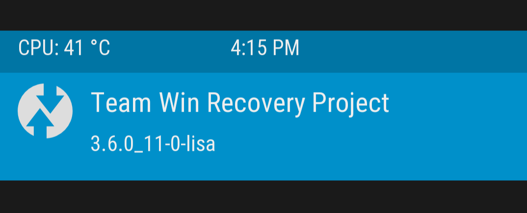

I have Xiaomi 11 Lite 5G NE (Lisa), and there is no official TWRP yet, but I found an unofficial twrp_lisa.img that is based on TWRP 3.6.0_11 (post #9):

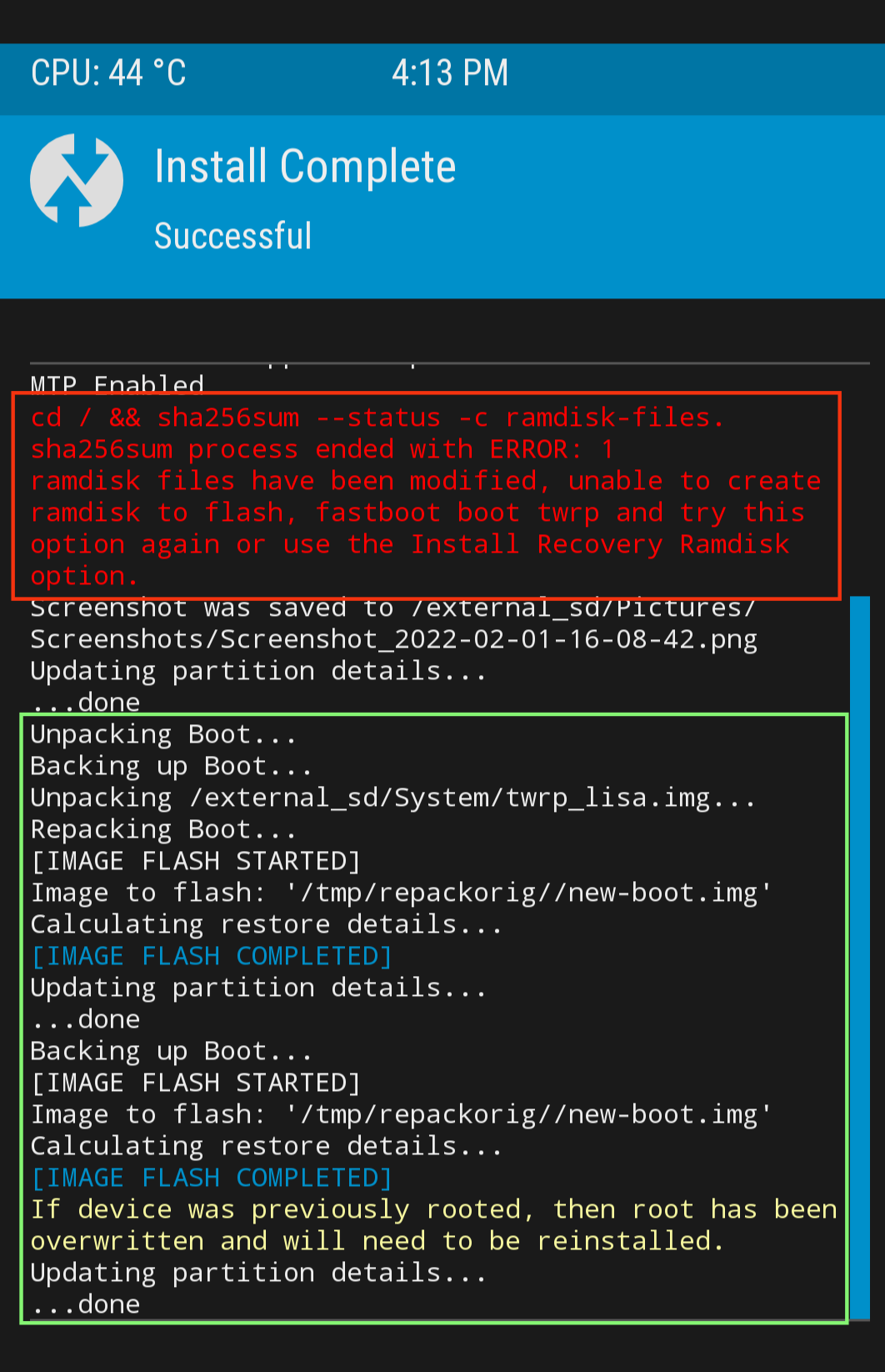

My Lisa is already rooted (still MIUI 12.5, A11 (MIUI 13, A12 not released for Lisa yet) - boot.img patched by Magisk and flashed to boot from TWRP
I wanted to see if it was possible to keep Magisk but also to install TWRP permanently
Then I temporarily booted to TWRP (fastboot boot) and tried:

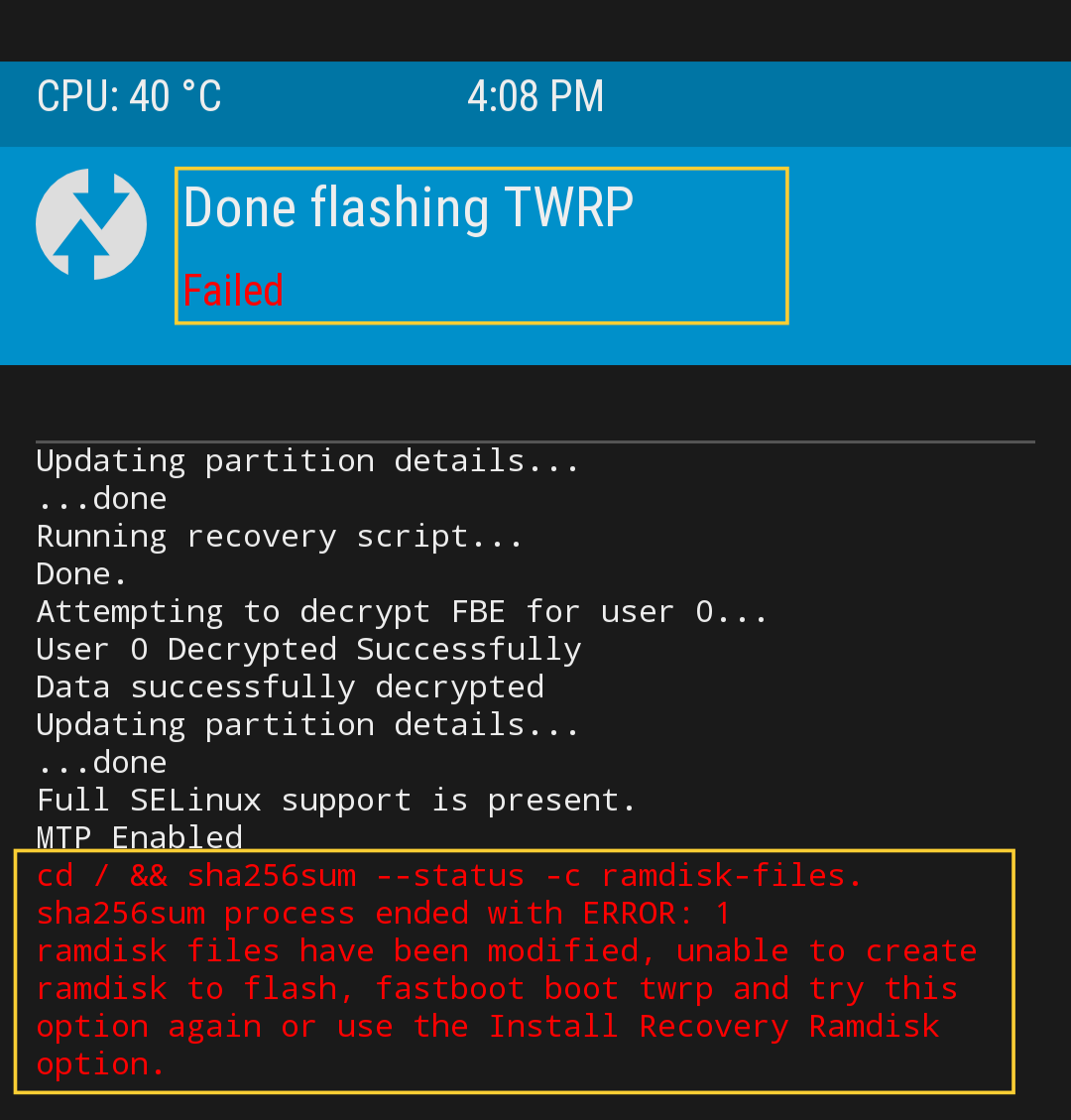

1) Advanced / Flash current TWRP:
It failed (screenshot) complaining that recovery ramdisk was modified (supposidely due to my patching the boot.img by Magisk)
2) Advanced / Install recovery ramdisk:
It flashed successfully my TWRP img file but noted me (screenshot) that root was now overwritten.
Indeed, when I booted to System, Magisk app was showing no Magisk installed and I had to flash once again my patched boot.img (with Magisk then overwriting the TWRP)
All together, TWRP can be installed permanently but cannot (easily?) have Magisk and TWRP, permanently, in parallel - since both patch the Boot
