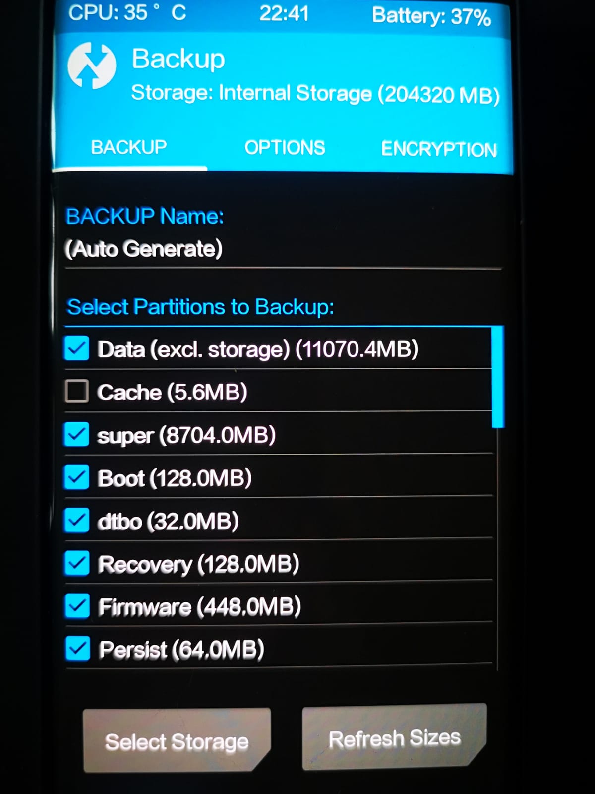

Well none of you guys did a full backup/restore on mi 10 ultra, on android 11 ?
I wanted to check which partition to save / restore exactly in order to keep : settings, apps, files, ROM version, magisk and magisk modules.
Any help ?
I attached all listed partitions.
