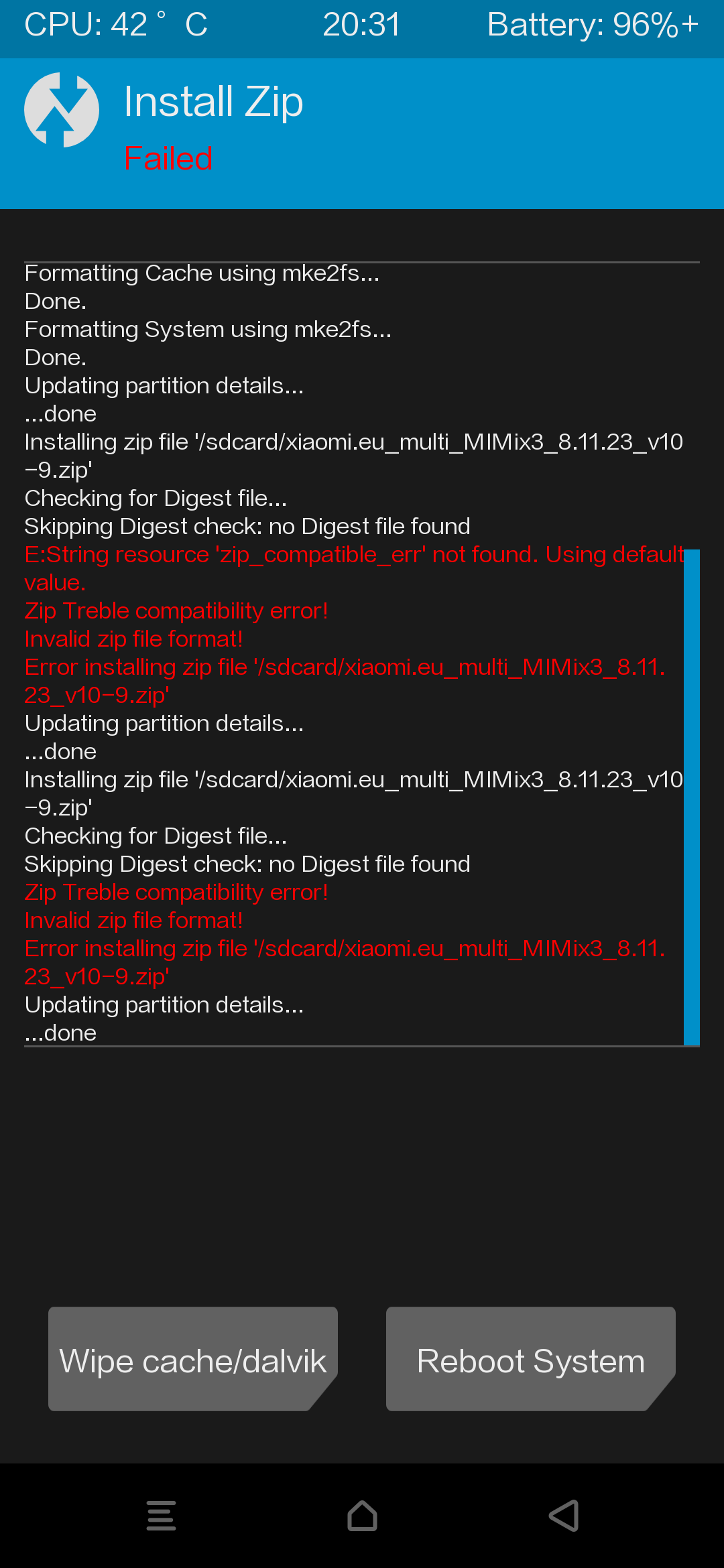

I can confirm the TWRP-3.2.3-1124-XIAOMI_MIX3.img is working fine. I am able to install china dev and magisk, EU ROM still stucks on Mi logo. I already tried flashing vbmeta, another boot.img and disable verity, everything without success. :(
Could someone explain why this doesn't boot and the china ROM does? Is it related to the new pie permission or something like that?
Thank you all in advance.
EDIT:
In the attachment there is also log for installation of globeROM, there are a lot missing files when I understand it correctly?
Tried to install xiaomi.eu ROM, it says zip treble compability error?
  • globeROM_install.txt
