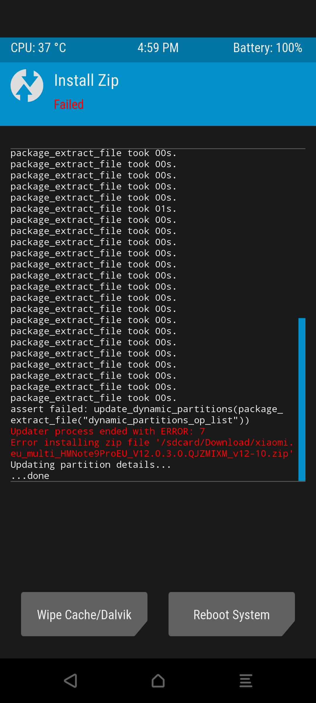

"Error: 7" is the default error code when zip installation is failing. ;)
Your issue is => assert failed: update_dynamic_partitions
I don't know how to fix this issue, try an older TWRP version or... wait another answer. :)

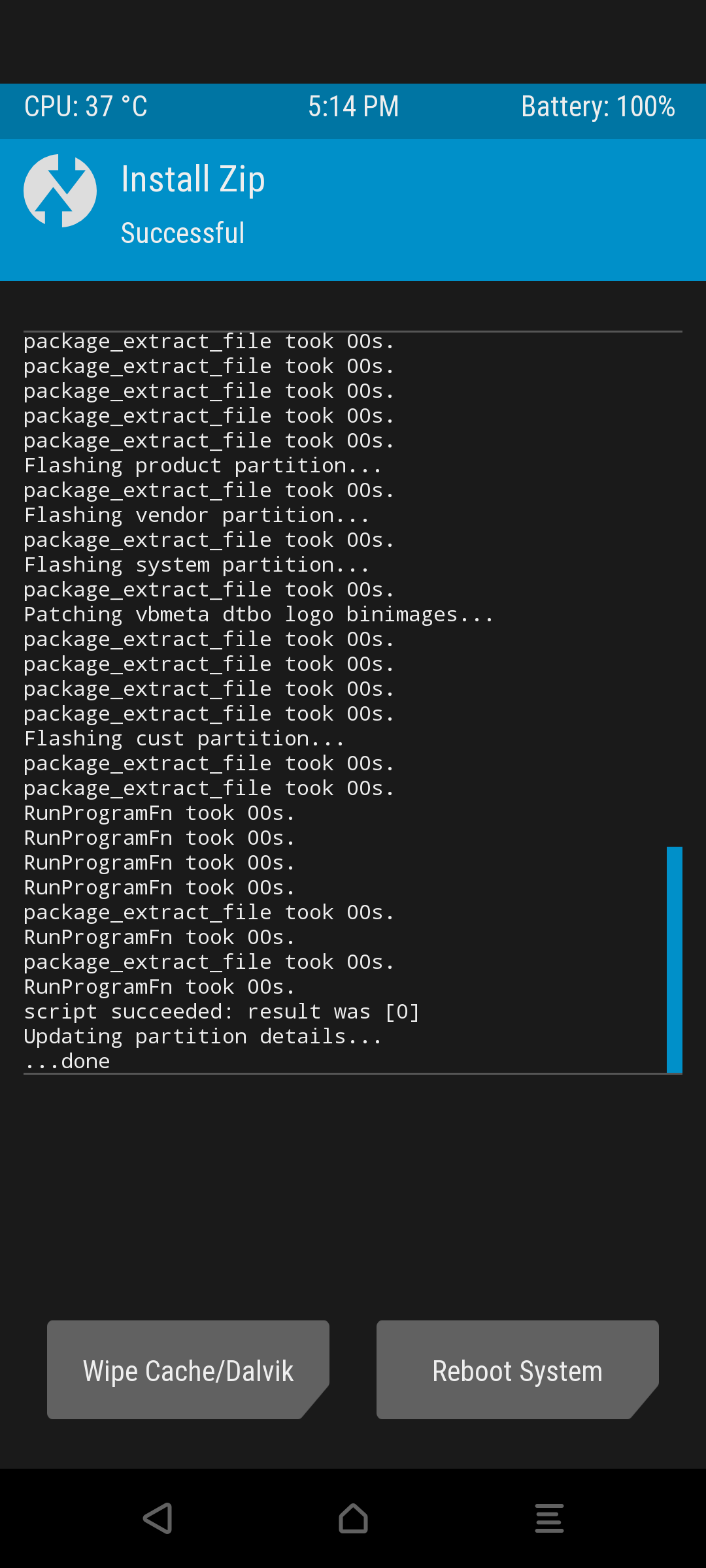

The older TeamWin TWRP 'TWRP-miatoll-v2-31032021.zip' installed fine.
I boot the TWRP rather than install, but that shouldn't make a diffrence.
So I guess the newer version has something with system_ext or something changed with reading the partition structure that only a full format would fix.
Cool! :)
I think you are right about the partitions problem. ;)
So it's not always good to install the latest TWRP if the old one is (still) working fine. :D

Do you actually have a system_ext partition to mount? Looks like it's a new partition introduced in Android 11.
Not sure why the assert failed but passed using an older version of twrp though

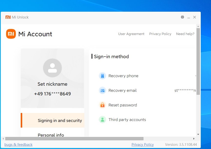

hi
i d really like to unlock my device again and go from stock to xiaomi eu rom with twrp
but i am kinda confused on locked bootloader with miunlock tool:
after sining in on phone and miunlock tool i only get account overview and a settings icon but no unlock screen?
whats wrong here please?

hi
There should be an option to view the logs if you click the gear icon in the top right. You should also update your copy of the unlock tool -
Download v5.5.224.24

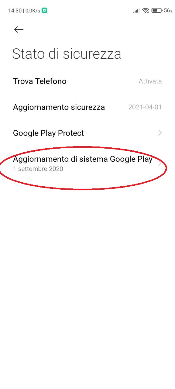

But I have a question: Why is the update to the google play system so old? (updating and then restarting doesn't change anything) do you also have this problem? (second image circled in red)

upgrade to V12.0.1.0.RJZMIXM_v12-11 succeeded thanks to
PBRP-miatoll-3.1.0-20210330-1801-OFFICIAL (from today their site is suspended, do you have any news about it ??!)
U can update the Google play.. just press there
Enviado do meu Redmi Note 9 Pro através do Tapatalk

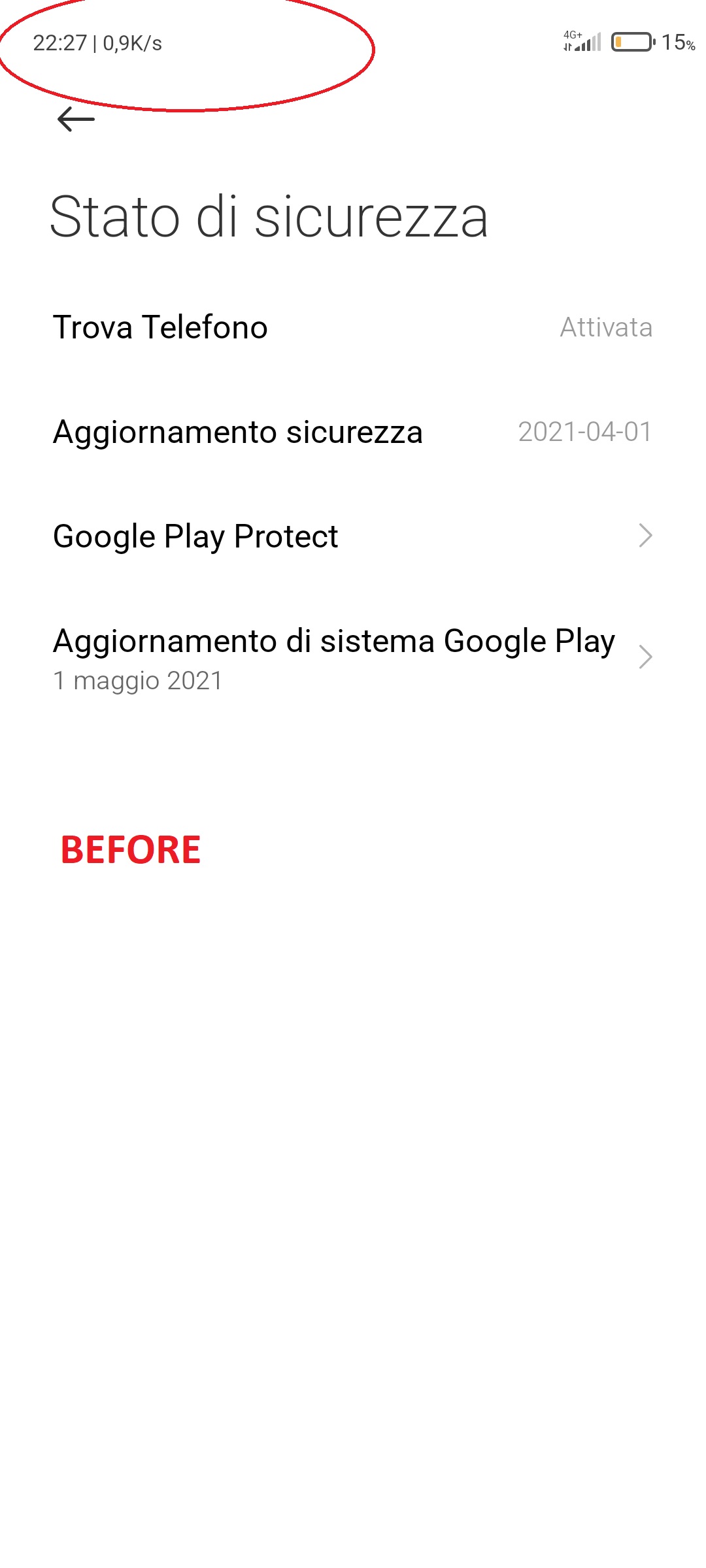

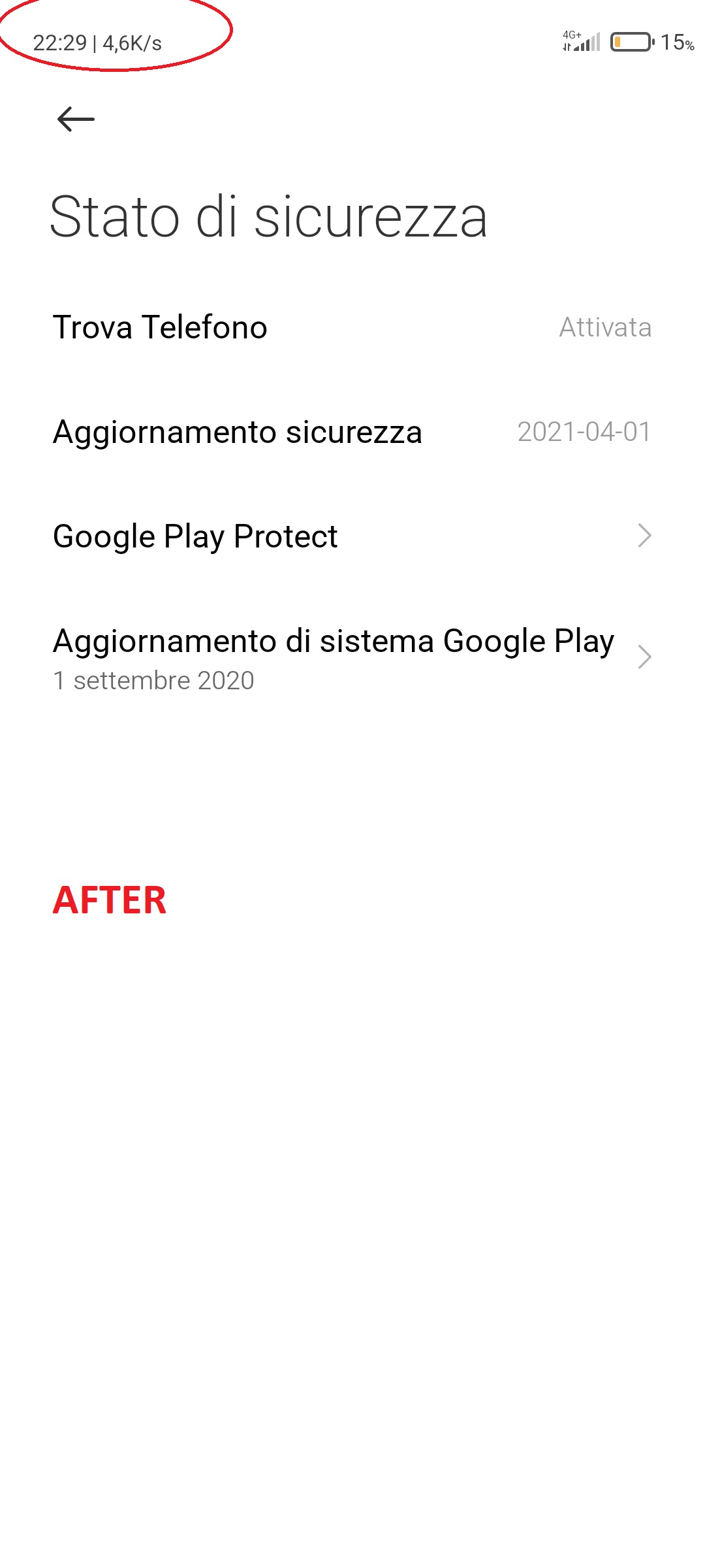

i tried to do this, but when i reboot it always remains 1 / sep / 2020.
that's why I was wondering if you also had this problem
clicking on update and the next restart appears 1 / May / 2021, but after a few moments the phone restarts by itself and returns to 1 / September / 2020.
PS:I did a clean install for V12.0.1.0.RJZMIXM_v12-11
some advice?
some advice?
SEE TIMETABLE IN THE SCREEN
Do it again
