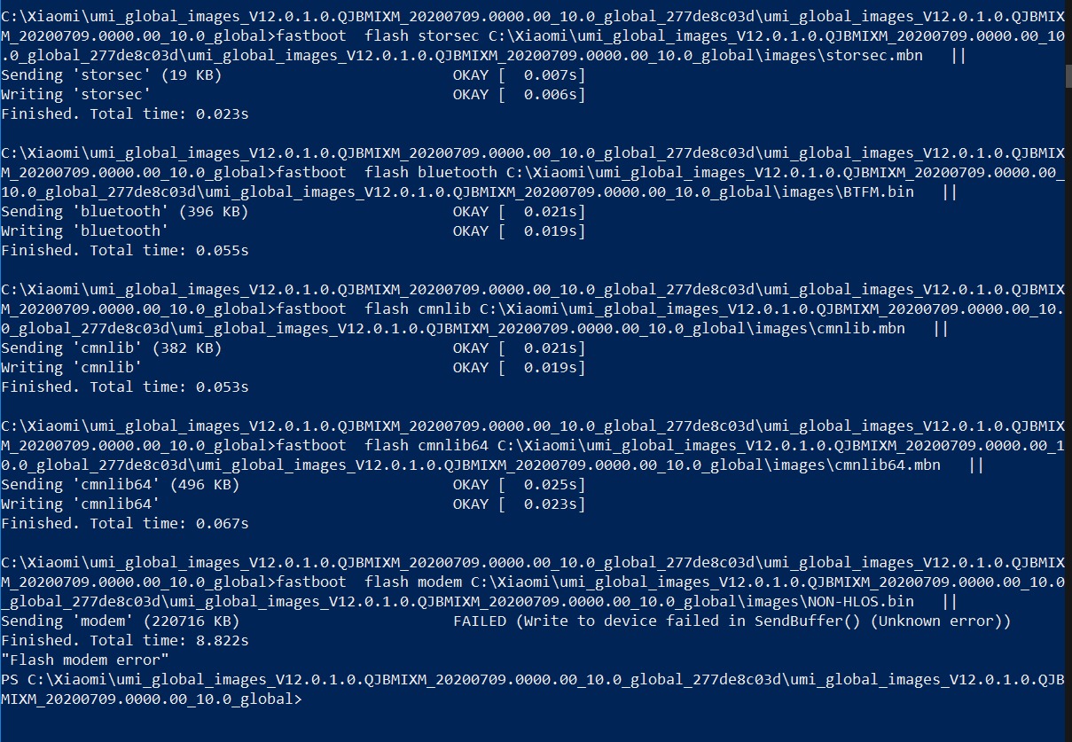

XiaoMiTool V2 restore feature for bricked phone, but after a bit it stopped saying "Flash Modem error".
So it restored the default recovery but now the phone is there and it does not seem to move from that point.
I hope there is some chance to re-life it.
Update: even trying to installing the standard MIUI 12.0.1 global using MiFlash Tool this is the result.
