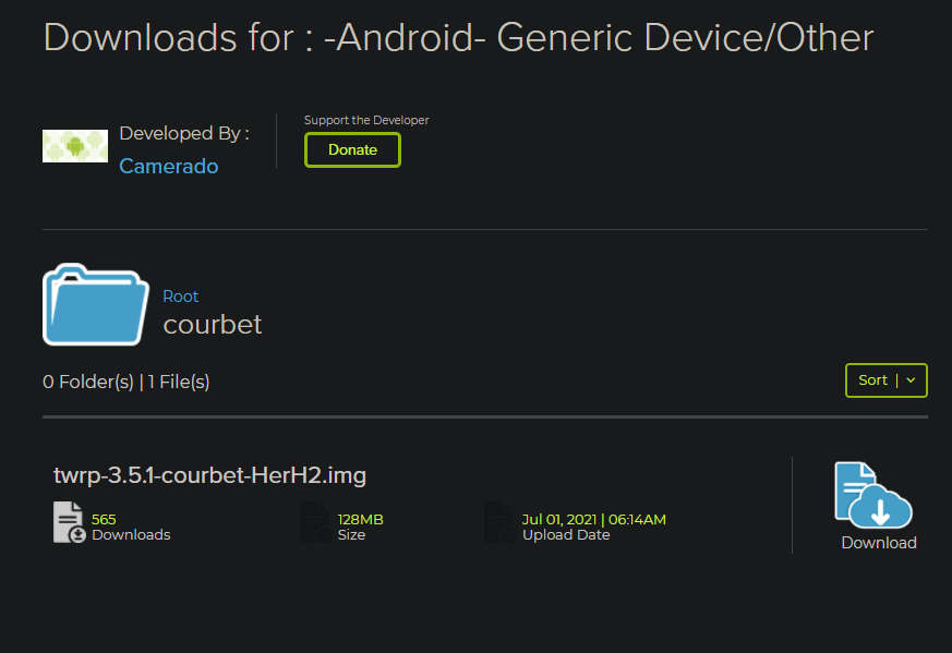

There is a TWRP 3.5.1 file for
our courbet. Can I install on my mi 11 lite? Or is there another way to install the miui.eu rom?
There is a TWRP 3.5.1 file for our courbet. Can I install on my mi 11 lite? Or is there another way to install the miui.eu rom?
Mi 11 lite 4G - courbet
Mi 11 lite 5G - renoir

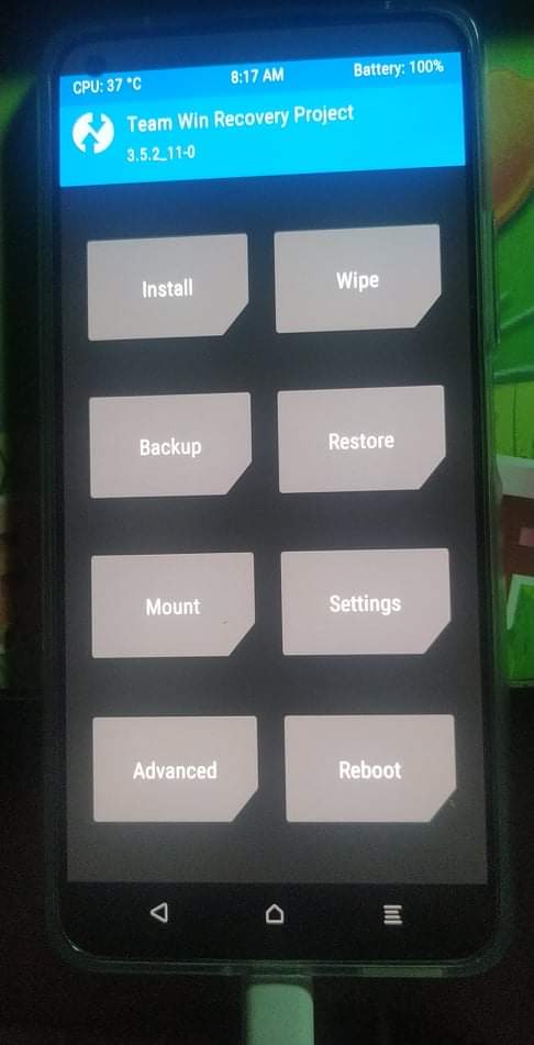

the HerH2 version for Mi 11 Lite 4G (its the only twrp for the device to date), and I followed the instructions from the XDA thread of that twrp.
I dont have the errlog at hand, but what happened are:

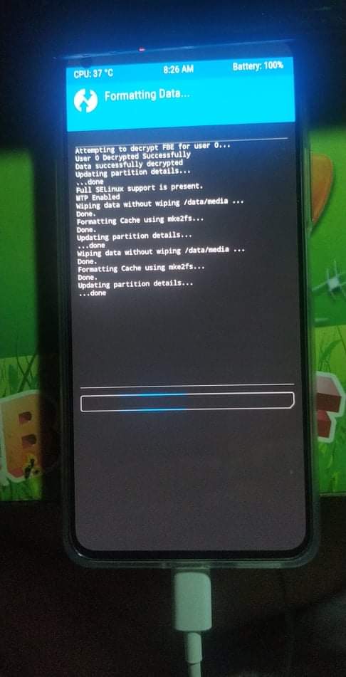

- try "wipe data" stopped at updated the partition information without the back button, subsequently trying that results the same.

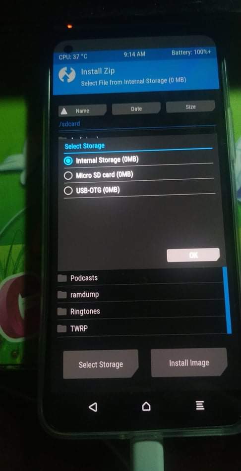

- try flashing the latest xiaomi.eu rom for the device from sdcard after mounting results in kicked out even before checking zip signature, sdcard "unmounted", and terminal log is without logs of trying to flash the rom. use different sdcard result the same.
