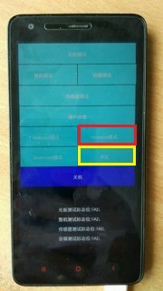

when i boot to recovery I get this, is this supposed to be? I always just click recovery than I get in TWRP
Same issue here, Same screen, too

i haved that issue too. google for xiaomi boot mode recovery (i still cant post a link on this forum)
on the bottom right there is a translation button from chinese to english and then u have a recovery, fastboot, and download mode.
yellow mark (chinese to english)
red mark (recovery)
