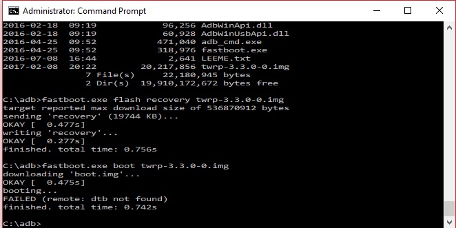

On Windows doesn't work either:
Print screen attached.
Twrp 3.3.0.0?
Where It is
i have 3.0.3.0
Try with this...
Finally, it worked! Thanks for your great support which is much appreciated!
