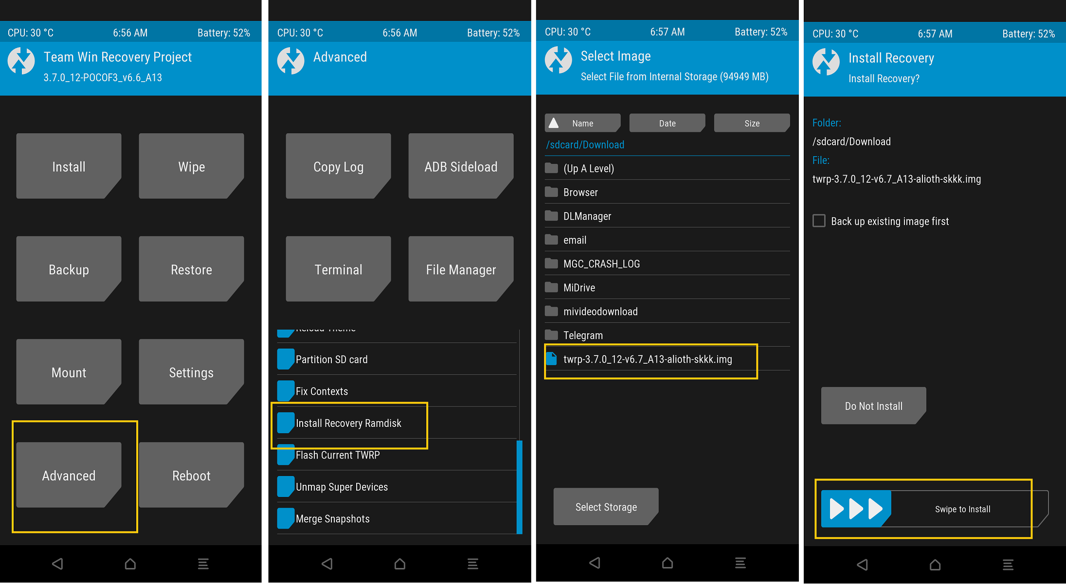

Hi. I'm using TWRP twrp-3.7.0_12-v6.7. Now i want to upgade twrp-3.7.0_13-v7.0.
But i don't see the Recovery partition in the list bellow. So, what partition should i choose? Thanks!

You didn't write the most important thing, it depends on what device it is. If you have a Redmi K40S, the procedure is as follows.
Install Recovery Ramdisk
Sent from my M2012K11AG using Tapatalk
