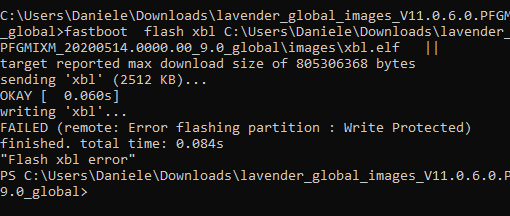

1) Install other recoveries with fastboot (Orangefox, TWRP, Stock recovery) and depite the installation succeed, none of them worked; when I try to enter the recovery mode, it's still stuck into OrangeFox logo (also after I've installed other recoveries).
2) Install MIUI global fastboot rom with MiFlash tool. It reports error xbl.
3) The last thing I tried: several attempts with fastboot and MIUI global fastboot ROMs. In all the cases the reported error was the write protection of xbl.

It was a step of flash_all script. It comes after the of rollback check (that I passed).
Anyway, in another forum someone suggested that it could be a hardware problem of emmc.

Here the result of the script runned on linux:
Code:
[daniele@daniele-x550ld lavender1]$ sudo ./flash_all.sh
product: lavender
Sending 'antirbpass' (8 KB)                        OKAY [  0.005s]
Writing 'antirbpass'                               OKAY [  0.000s]
Finished. Total time: 0.013s
Sending 'xbl' (2512 KB)                            OKAY [  0.075s]
Writing 'xbl'                                      FAILED (remote: 'Error flashing partition : Write Protected')
fastboot: error: Command failed
