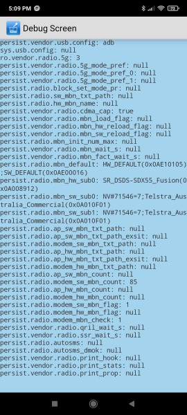

Installed this on stock and it gave this output, … I'm not sure because it said parts of the operation is prohibited or the null items aren't correct - but can't be certain.
Does any one know if the output is correct? If anyone could share an output the same as I did it would be greatly appreciated.
