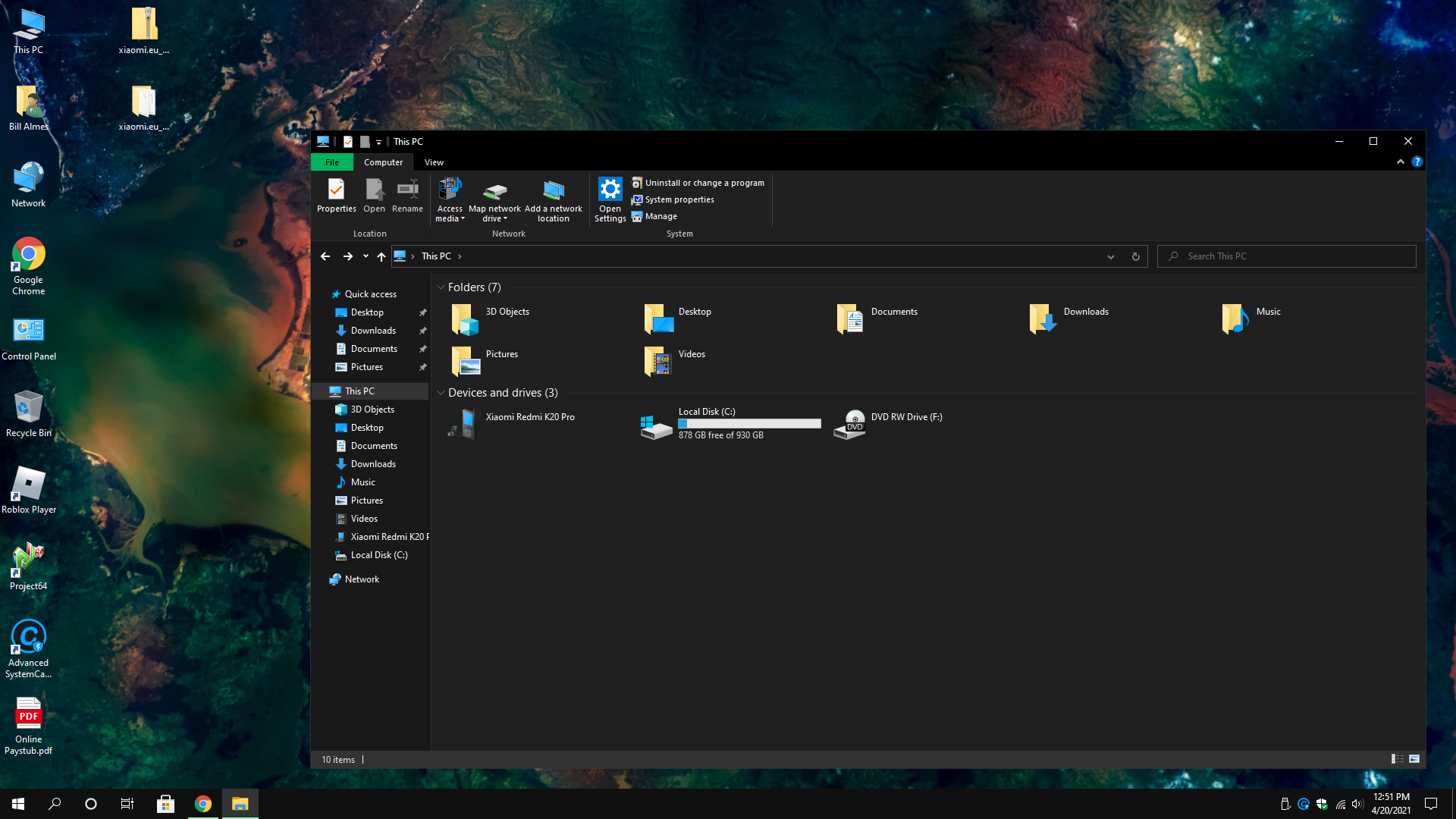

this is what i see when i have phone hooked up to my computer. i cant put anything in the internal hard drive. do i to install something or what setting do i need to change on TWRP? i cant transfer anything.
And what's inside "Internal Storage" in the Windows explorer?
Please check if "MTP" is enabled in TWRP...
