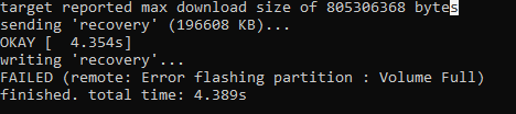

You downloaded the incorrect variant, starting with [BOOT]. It's clearly visible from the size: 196608KB.
You need the [REC] variant from here (notice that it should be 100MB):
the link that other users posted in the question I asked you on the last page, is for a 192mb twrp, so this 192mb is incorrect? the correct is this link that you posted now 100mb? Thanks again.
Yes, you have no reason to use the 192MB TWRP when the device has a dedicated recovery partition, which is better than the boot-as-recovery trend Google has been pushing.
