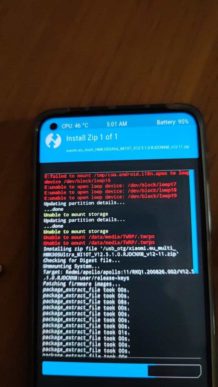

Hello, when I try to flash the Xiaomi.eu 12.5.1 it gives me this error ... What is it? I'm flashing from otg ... also flashing from the phone's internal memory
Go to the Mount menu and decrypt data. Put your pin, and retry. If it can't decrypt, flash a more recent version of twrp/pbrp

Helle, these red lines are not important errors if the installation is a success at the end. :)
Please screenshot at the end of the installation if you want help. ;)

Right too, this error is not serious.
Remember to wipe dalvik before reboot

ok, I try again and I make a screen, the Xiaomi.Eu rom for Mi10T is also good for the Mi10T Pro right?

at the end of the installation it gives me no errors
