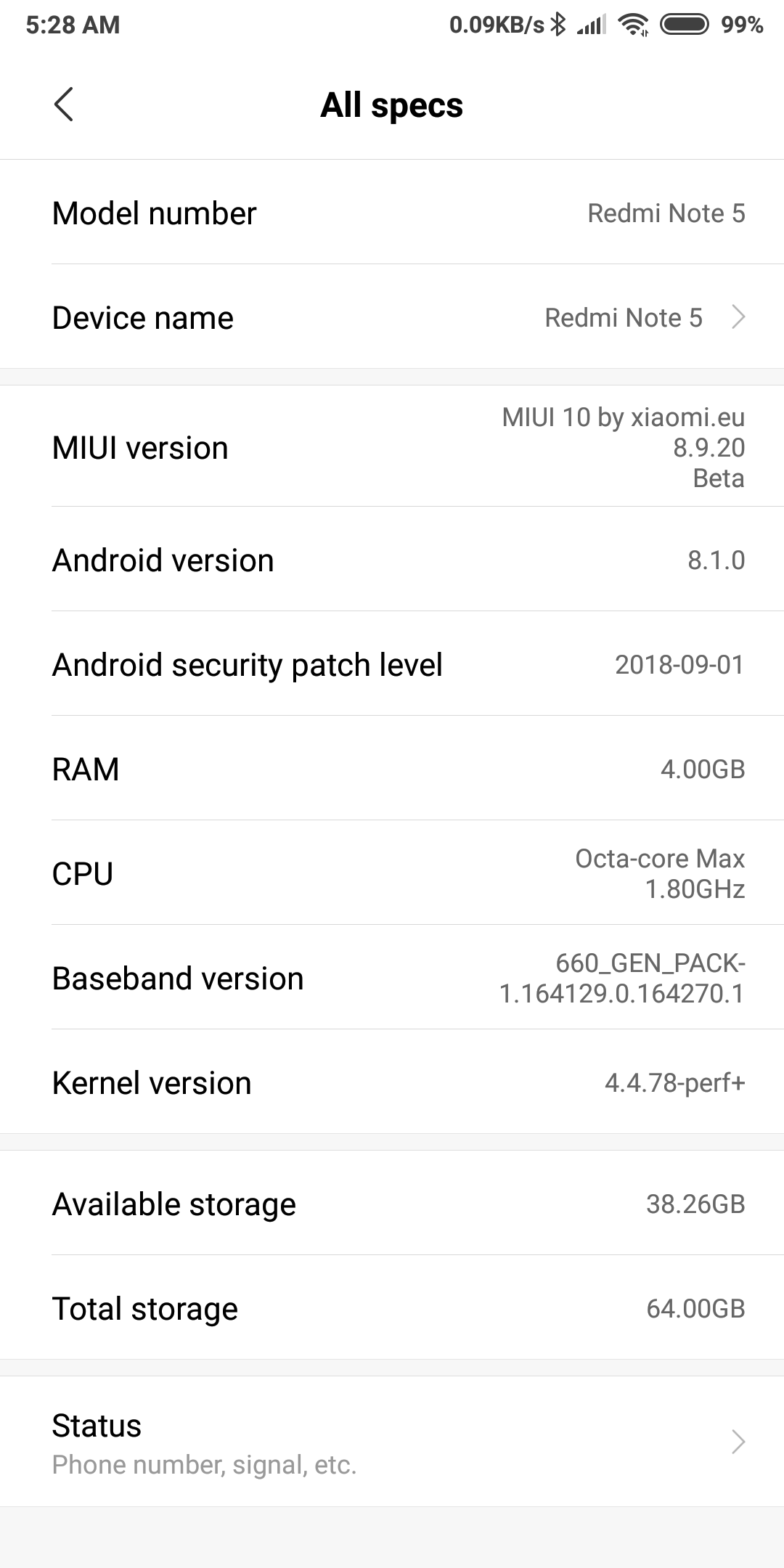

Well I finally got home and downloaded the update.... looked inside the firmware-update folder inside the zip file, and looked at the files within the firmware-update folder.... same files as 8.9.20, and 8.9.13.... since there was no anti-update within the previous 2 updates, I'm going to go out on a limb here and say that there are no anti-update files in this folder either...
