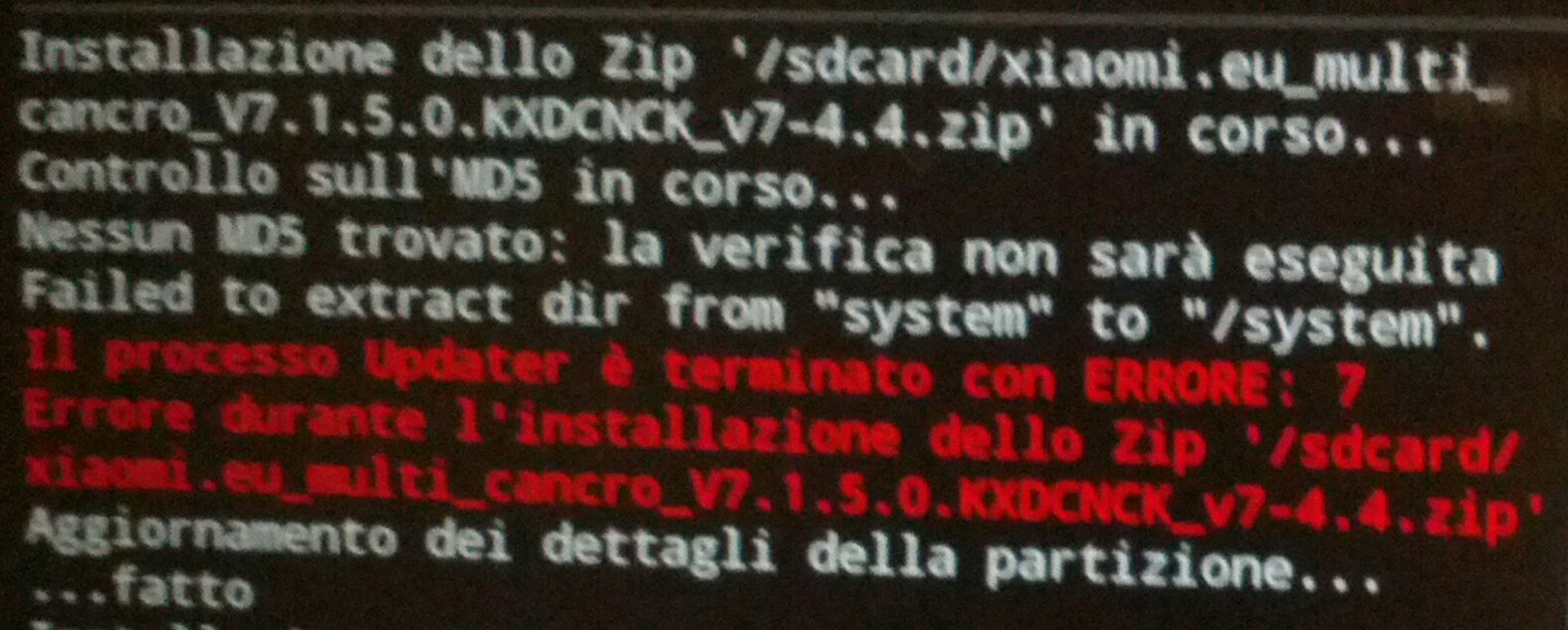

    Hi i have a Mi4 LTE-CU i need the italian language, the version V6.6.5.0.KXDCNCF_v6-4.4 work, but if i try to install all higger version via TWRP when i install the rom error 7 appear.
    Please Help.

  3. mdki1996
    mdki1996Members
    May 12, 2016
    30
    Male
    In particular what says twrp┬┤log?

  4. Mihai Enea
    Mihai EneaMembers
    May 16, 2016
    9
    Male
    So...to fix it, just go to Mount menu in TWRP and uncheck the option to mount system as read-only and then reflash the ROM

    I got the same problem before. I was on 4.4 and I was trying to install 6.0 using TWRP with the same error of system folder...
    I finally did with the default recovery app that Xiaomi 4.4 bring, without change it for TWRP and it works!! After upgrade to 6.X your 4.4 recovery will be replaced with TWRP :)
