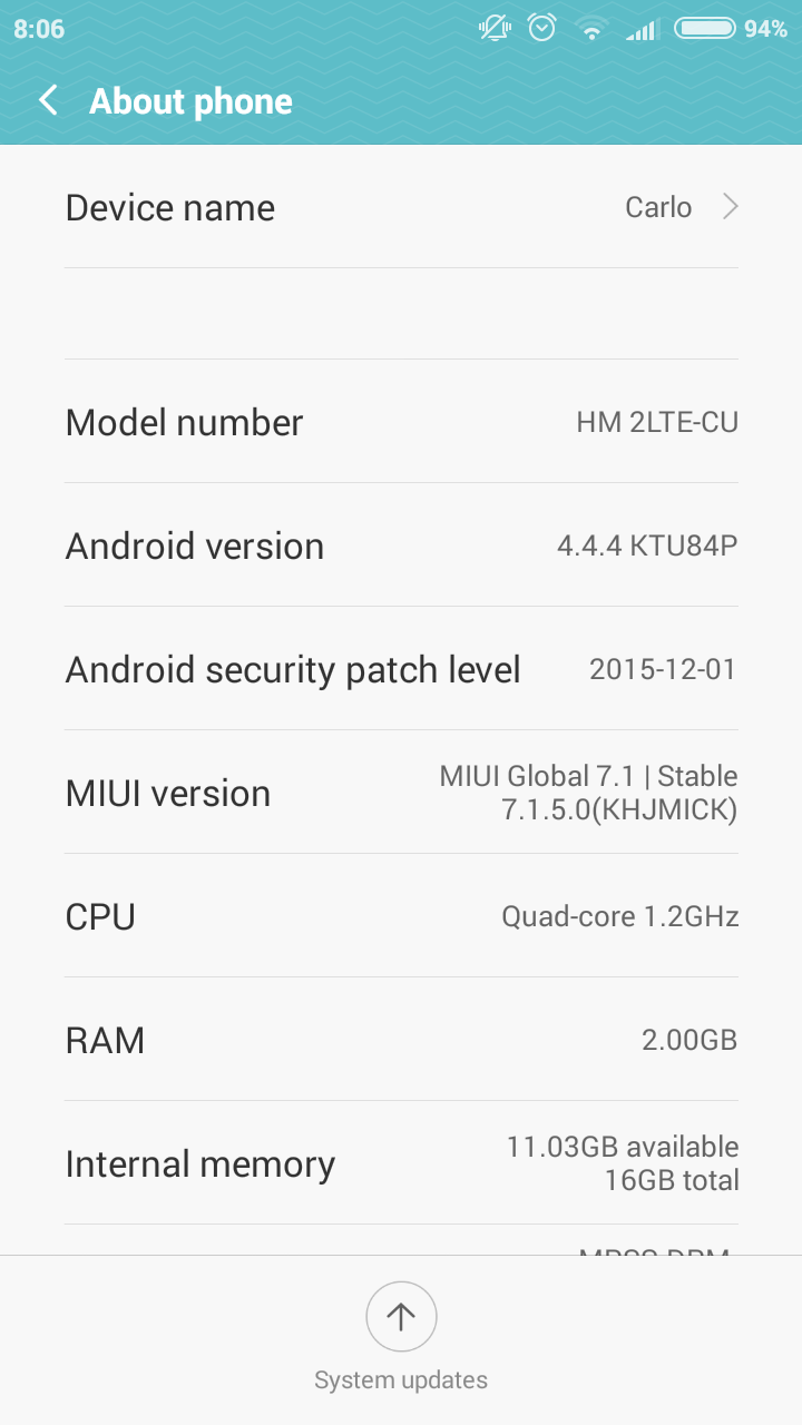

I have a Xiaomi Redmi 2 Pro with 2GB of RAM and 16GB of internal memory. Under the battery is written to be 2014811 and in setting 2HM LTE-CU.
I bought it from Gearbest, and it came to me with MIUI Global 7.1 | Stable 7.1.5.0 KHJMICK : it works with my carrier (I'm italian) but there isn't italian lenguage.
So I'm asking you which ROM I have to download to fix my smartphone.
I read a lot, but I didin't understand, can you help me?

Hello Carlo.
It's strange, because 20140811 is usually serial number of redmi 2 not pro. I've redmi 2 pro bought from grossoshop and I've always used the rom for 20140813 model. In any case to have italian language you have to flash a multilanguage rom that you can find her ein xiaomi.eu. You have to download the rom for your model and then flash it using twrp recovery. weekly rom roots you device and it's improved weekly by developers, while stable rom does'nt root device and it's improved more rarely.

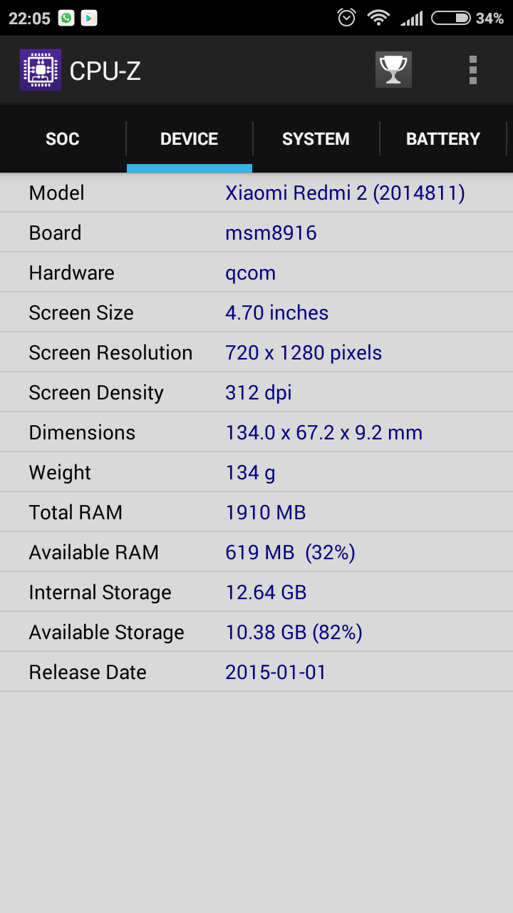

No, it isn't rooted and I don't have TWRP. Using CPU-Z...

It seems to be 2014811.i suggest to you di download AN old weekly rom for 20140811 from xiaomi.eu (of january for example) and flash it by updater.so you'll have the root and with it you can flash twrp recovery. Then you can flash the current weekly rom (now with Android 5.1).
Why can't I flash directly current weekly rom?
But, according to you, I'm downloading "xiaomi.eu_multi_HM2014811_6.1.21_v7-4.4.zip" is it ok?
New roms are quite different and I fear they need twrp recovery to be flashed. Stock recovery can flash only the official roms and not multilanguage. It happened in february /march. If you read the first Page of Last weekly roms in forum you can fine. That rom is ok. Try to flash it by updater.
Device accepted 2014811 update, so ufficially it's 2014811 model.

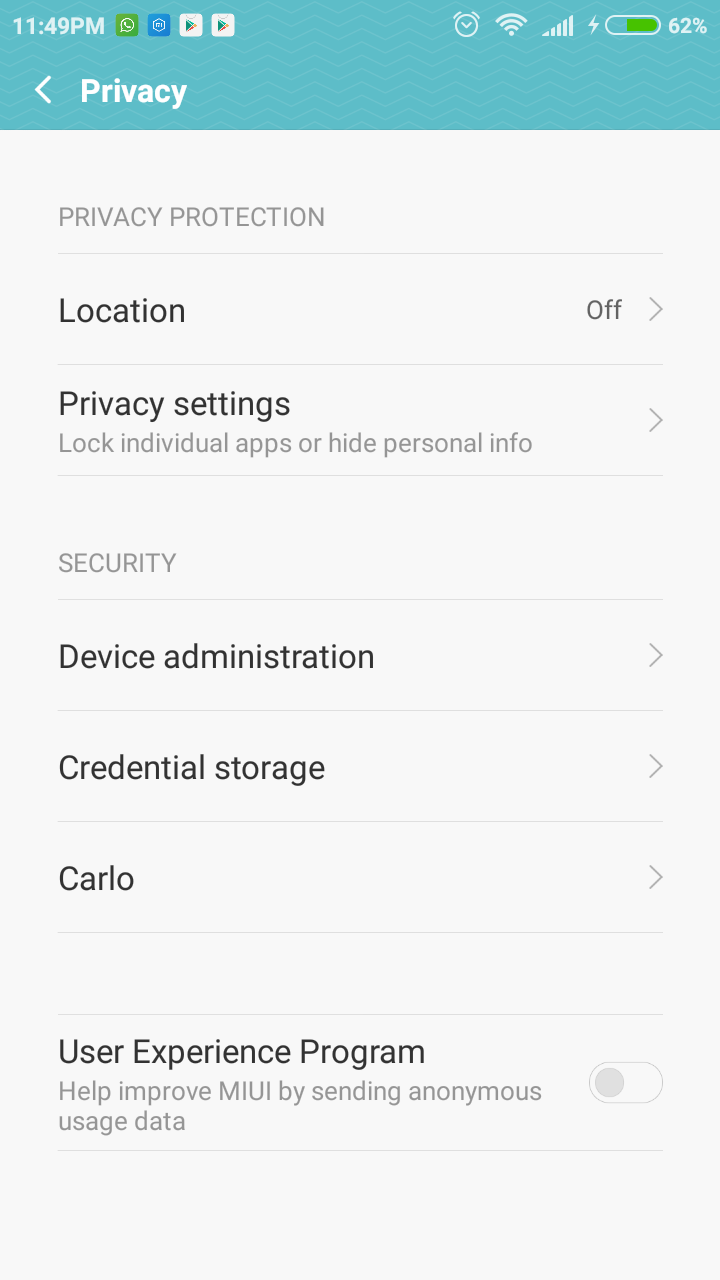

I checked but there is problem now. I downloaded Flashify but it said that I don't have root. What I have to do?
Ok, activated and also lenguage fixed. I downloaded TWRP for 2014811, but Flashify doesn't find it.

You have to selettiva flash/file zip/choose file and then find zip file of twrp by file Explorer/flashify. Depends were it id in your memory. I go sleep
Flashify only opens .IMG file and the twrp file that I downloaded from this site is zip. Extraxting is not right I think.
Thank you so much. Goodnight.
By flashify you can also flash zip files. Flash /zip file /choose a file/file Explorer (that with flashify icon). Then you have to find by file Explorer the zip file of recovery and flash it.
