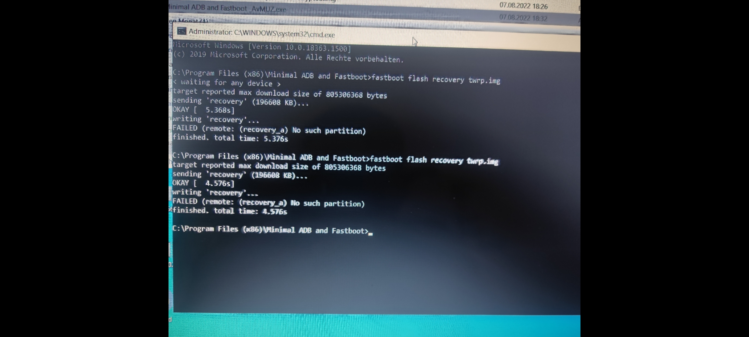

I Tried to install the TWRP with the following fault in the picture. What does it mean?

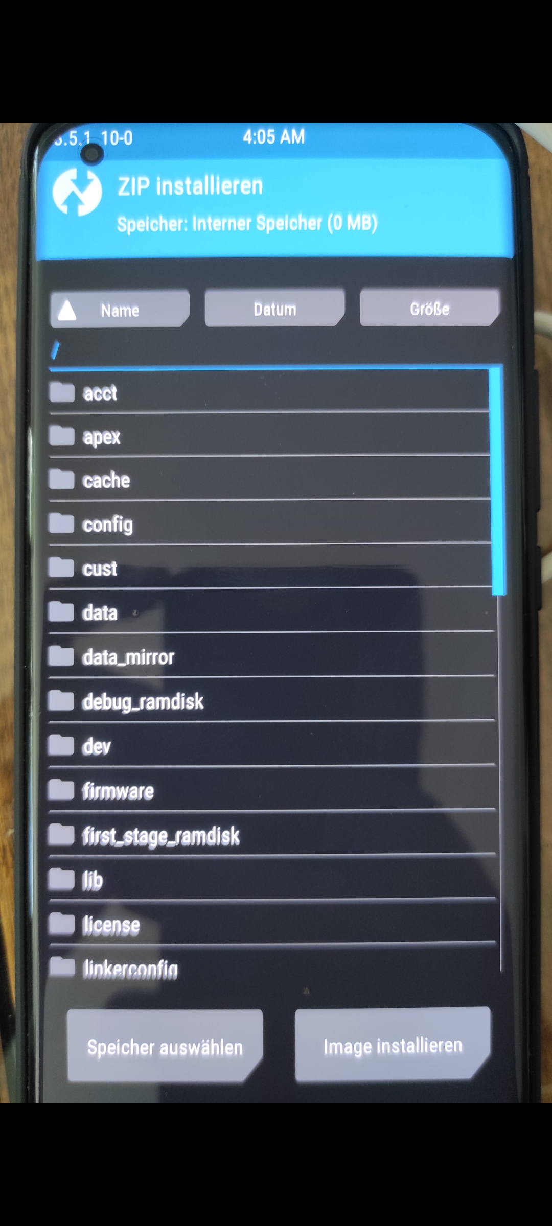

I booted now the TWRP. My zip file is in my downloads folder but I can't find it. The internal storage is 0MB and it looks like the root dictionary.
I tried a USB drive for install but he didn't accept it and shows also 0mb. I can't mount it. The TWRP didn't ask for my pincode. I disabled the PIN-Code and tried again without a result.
