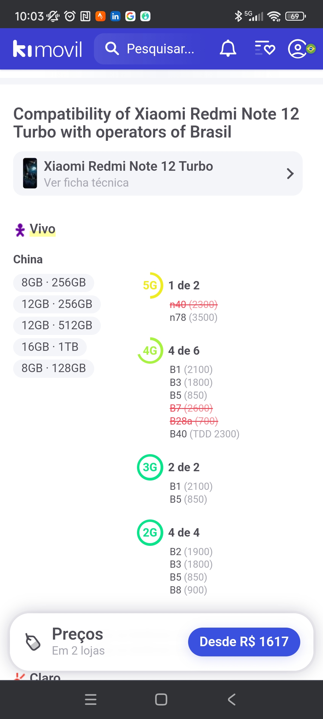

I forgot to add that the band coverage in my country for my operator. There are only a few bands missing, so it should not be a issue..... right?
