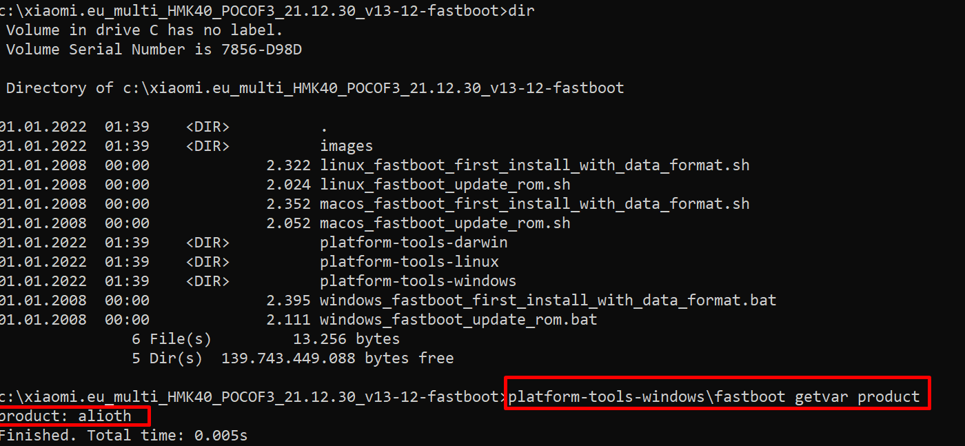

Please see the screenshot and run the command i put in red box in fastboot mode, the output should be alioth. What is your output?

you have to change into the directory where fastboot.exe is installed and phone must be in fastboot before you want to execute fastboot. exe command and check if you can see your device with fastboot devices
fastboot getvar product
see my detailed description

C:\Users\Stasc>cd C:\Users\Stasc\Downloads\Poco F3\Rom\Fastboot
C:\Users\Stasc\Downloads\Poco F3\Rom\Fastboot>dir
Volume in Laufwerk C: hat keine Bezeichnung.
Volumeseriennummer: AE54-AEA9
Verzeichnis von C:\Users\Stasc\Downloads\Poco F3\Rom\Fastboot
05.01.2022 19:10 <DIR> .
04.01.2022 18:41 <DIR> ..
03.01.2022 18:32 <DIR> images
01.01.2008 00:00 2.322 linux_fastboot_first_install_with_data_format.sh
01.01.2008 00:00 2.024 linux_fastboot_update_rom.sh
01.01.2008 00:00 2.352 macos_fastboot_first_install_with_data_format.sh
01.01.2008 00:00 2.052 macos_fastboot_update_rom.sh
03.01.2022 18:32 <DIR> platform-tools-darwin
03.01.2022 18:32 <DIR> platform-tools-linux
04.01.2022 19:39 <DIR> platform-tools-windows
01.01.2008 00:00 2.395 windows_fastboot_first_install_with_data_format.bat
01.01.2008 00:00 2.111 windows_fastboot_update_rom.bat
01.01.2022 10:37 3.944.620.958 xiaomi.eu_multi_HMK40_POCOF3_21.12.30_v13-12-fastboot.zip
05.01.2022 19:10 3.897.462.712 xiaomi.eu_multi_HMK40_POCOF3_V13.0.2.0.SKHCNXM_v13-12-fastboot.zip
8 Datei(en), 7.842.096.926 Bytes
6 Verzeichnis(se), 342.853.799.936 Bytes frei
C:\Users\Stasc\Downloads\Poco F3\Rom\Fastboot>platform-tools-windows\fastboot getvar product product:alioth
< waiting for any device >
getvar:product FAILED (Status read failed (Too many links))
fastboot: usage: unknown command product:alioth
getvar:product FAILED (Write to device failed (Too many links))
The point is you messed prop build file on your alioth phone and you are in pain to upgrade.
Only solution is MIFLASH fastboot rom to recover it or modify fastboot EU rom internal script. 'not recommended if you don't know about)
Than you for the help and info, i have learned a couple of new trics but i have no success.
tried miflash but this new fastboot rom has no flash all script so i will have to wait.
