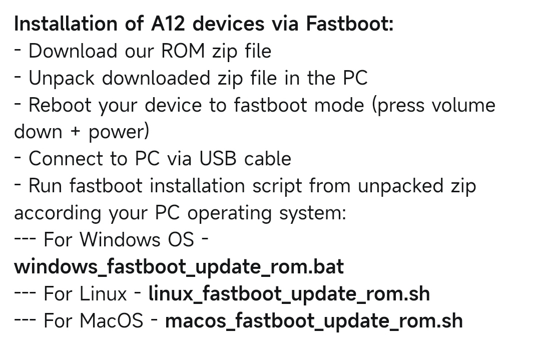

it is described on the first page…
Installation of A12 devices via Fastboot:
- Download our ROM zip file
- Unpack downloaded zip file in the PC
- Connect to PC via USB cable
- Run fastboot installation script from unpacked zip according your PC operating system:

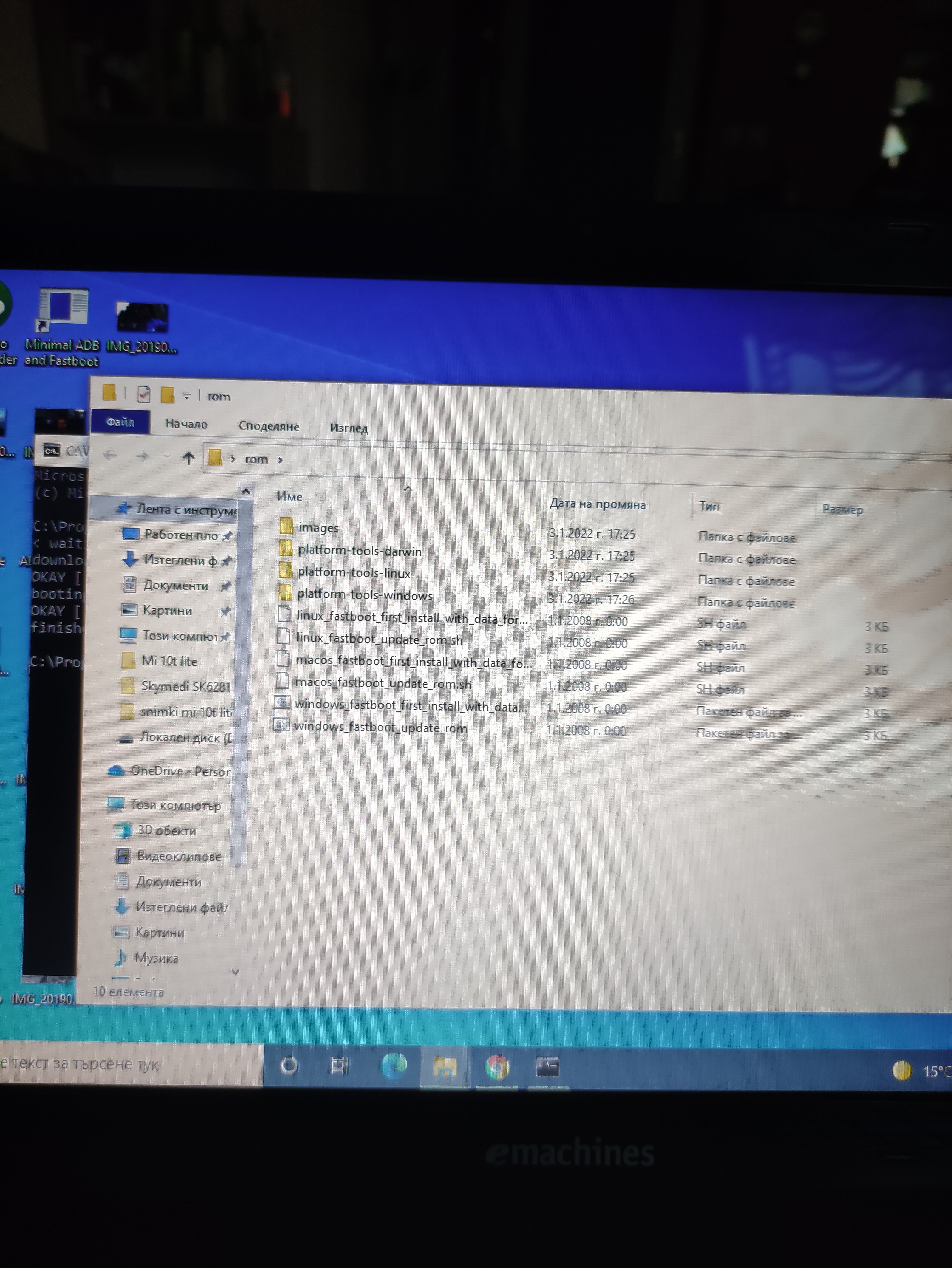

Again, nothing happened. could you please explain to me step by step?I unzipped the files but still couldn't install them
did u install fastboot / adb driver on yr pc / laptop? if not u have to install it first
yes i installed the driver on the computer I don't know if it matters, but I'm with Android 11,,I unzipped the whole package on my computer
u can try install this , see if its working for u
I downloaded what you sent me and installed it on my laptop now what to do Please say Step by step

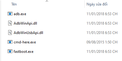

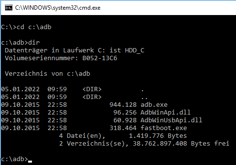

I suggest....
- you need an unlocked bootloader
- install USB drivers & adb and fastboot tools
- create a directory c:\test
- download fastboot image for your phone to PC
- extract the fastboot image into this folder c:\test
- open "cmd.exe" on your PC
- change to directory were you have installed adb & fastboot
- eg cd c:\adb and type dir
- there should be this files:
- connect PC and phone with USB cable
- put phone in fastboot (reboot phone and then holding "Volume -" and "Power on" buttons simultaneously)
- you should see a bunny picture and an info "fastboot" on the phone
- type in "cmd window": fastboot devices
- check if you see a number -> then all is fine
- if you dont see a number:
change USB port / change USB cable / use USB 2.0 / use an USB Hub / check driver installation
- "cmd window" should be open on PC
- change to c:\test eg cd c:\test
- start the appropriate bat-file
It depends if you install the xiaomi.eu rom for the first time / you change between weekly and stable or as an update from weekly to weekly or stable to stable
windows_fastboot_first_install_with_data_format.bat
(install for first time or if you change between stable and weekly)
windows_fastboot_update_rom.bat
(update from another weekly to weekly or stable to stable)
If you want to change between stable and weekly you have to choose the bat file with format in the filename
