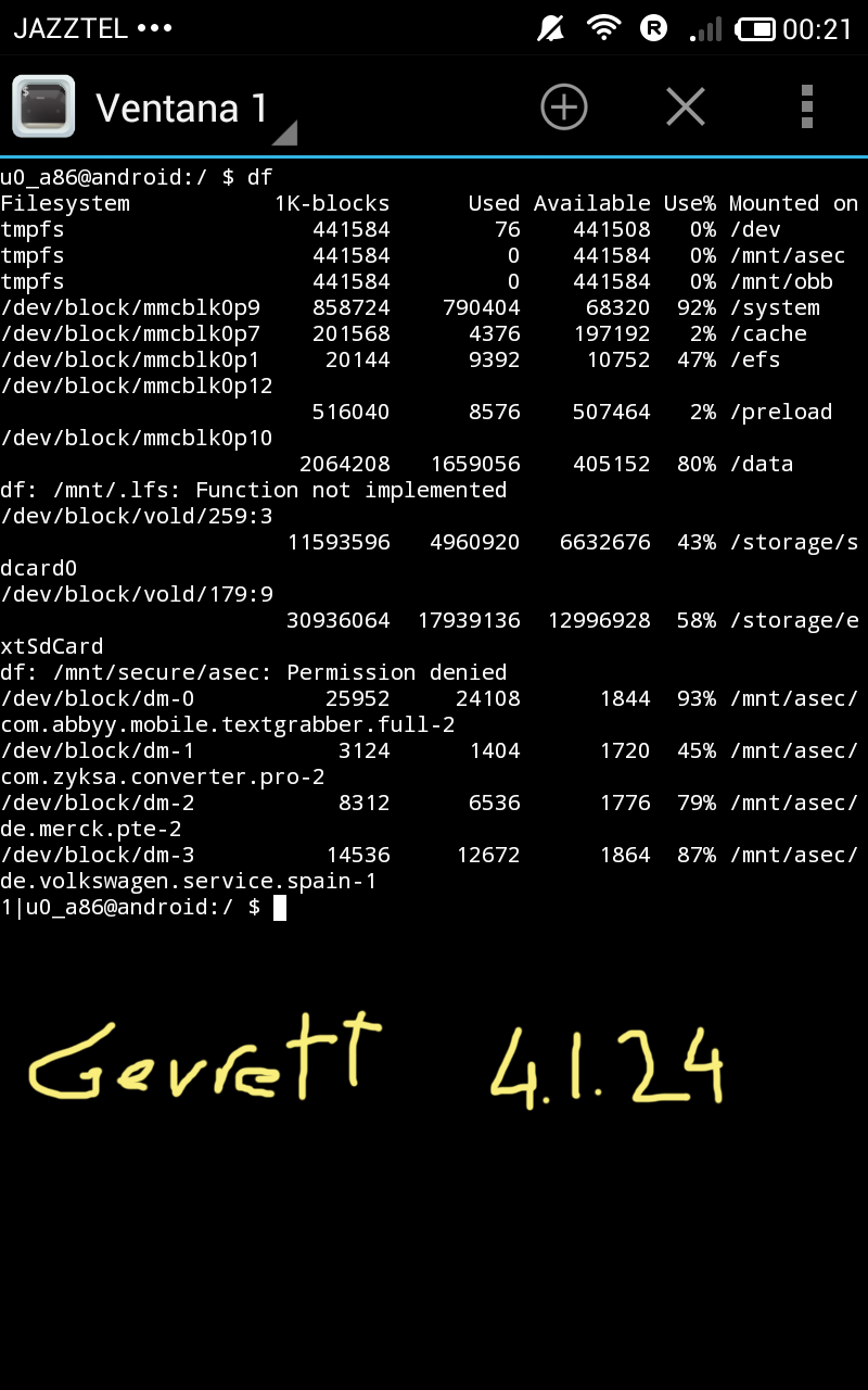

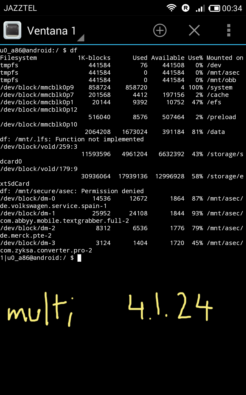

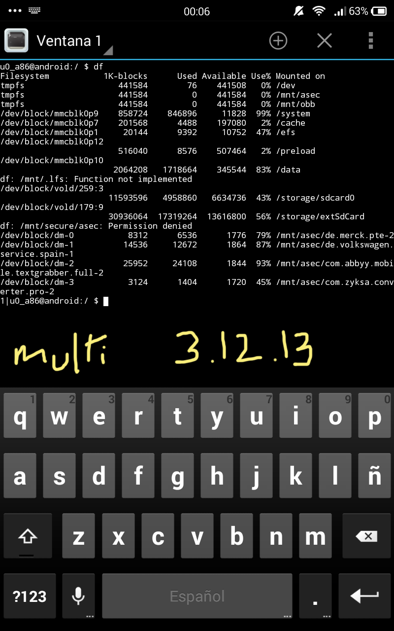

I've made 3 screenshots:
- First is last miuiandroid multi ROM working for N7000: 3.12.13
- Second is this weekend Gerrett ROM 4.1.24
- Last is this weekend miuiandroid multi ROM that give us problems: 4.1.24
Great!
Now we know where is a problem...
/system is full... That is causing all your issues... We will clean up rom a little...

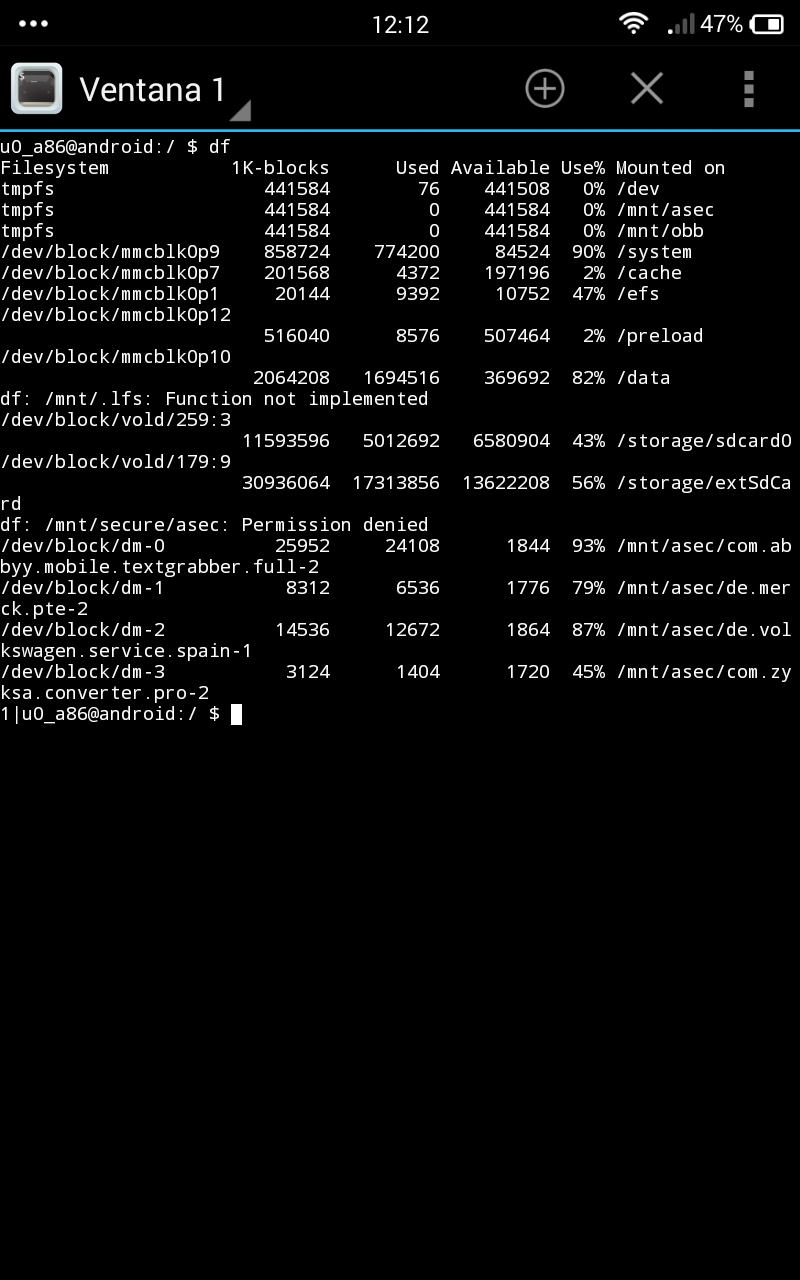

Can I free some space directly from ZIP file? I'm thinking about deleting other languages files in /T9DB.
could it work?
EDIT: First I clean other languages in /system/T9DB in my phone. Then dirty flash mutilang ROM, cleaned previously and all is working fine. Root access, theme manager, ...
Anyway a cleaned ROM multilang for everybody will be much better.
