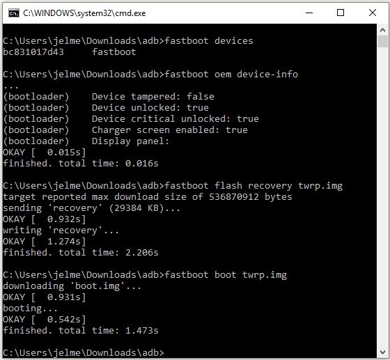

Hi all,
I've bought a Xiaomi Redmi 3s (2g/16gb version) and would like to install the xiaomi.eu ROM. To flash the ROM, first the TWRP recovery needs to be flashed using fastboot. The phone is recognized by fastboot, and the bootloader has already been unlocked succesfully using the Xiaomi unlocking tool. This has been checked using the 'fastboot oem device-info' command. The flashing seems to go fine, and the process finishes without any complaints, but in the end the stock recovery is still there on the phone. I've attached a screenshot of the fastboot commands and responses. I tried it with a laptop running Windows 10 and a computer running Windows 7, same result. Is there anybody who can help me?

I had to flash TWRP thrice to get it to "stick". But, using the "fastboot.exe boot recovery.img" did get me into TWRP.
So, I would suggest rinse & repeat, because judging by you screenshot everything should be ok!

Thanks for your response! Right now I tried it already about 5 times, but still no TWRP. A while (10s or so) after the 'boot' fastboot command is given the phone reboots, but just to MIUI.

I appreciate your input, but as you can see in my first post I've already done that. I tried the tool (simply a batch file) where you are refering to and I also used the command "fastboot reboot recovery". TWRP seems to install fine, but it doesn't work. See the screenshot I've attached to my first post.

Give this a try...after issuing the command fastboot boot recovery.img BEFORE pressing enter...press and hold the volume UP button and then press enter on the PC......
Thanks for you response! I just tried it, and it didn't work for me. But I have some new information which might help us. I only used the flash command, not the boot command this time. I booted manually into the recovery, and the first time I tried to boot in the recovery it rebooted after a while. This time, it went directly through to MIUI. When I tried to boot the phone in recovery for the second time, the phone booted to the original recovery again.
In the end it seems that there is flashed 'something', but it doesn't seem to stick. Tried to flash multiple times, no luck.

Hey, I think i just find the solution, tell me if it's working for you :
I used this TWRP :
Use theses commands
(cd downloads)
"fastboot flash recovery recovery.img" (the file you just downloaded)
DO NOT fastboot boot recovery.img
"fastboot reboot" HOLDING +/up bouton, chose 'recovery' -> Do you really wanna boot recovery mode ? 'yes'
TADA
