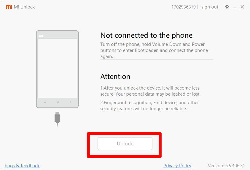

AS per screenshot. I rebooted to FASTBOOT (logo shown on phone, albeit a bit dim), and connected to PC, but the unlock button is still greyed out. USB debugging definitely works because I can see it under adb devices.
I'm on miui 14.0.12 CHINA ROM stock currently. Please help!

You're supposed to boot to bootloader mode !
It says so on the screen itself !!!

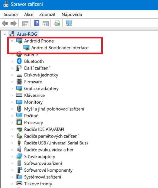

Check the "device manager" on the PC to see if the phone is visible after connecting the mobile in fastboot mode.

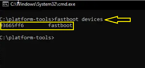

You can also type the command > fastboot devices < in CMD after connecting the device to the PC in "fastboot mode".
Did you also install the Xiaomi drivers?

yes the phone is visible in device manager, and it can be seen in fastboot devices.

I also checked devmgmt again, and now it doesn't appear there too.
I checked fastboot devices, and it came back with a NIL response.

I confirm it gets stuck when trying to install Mi Drivers. I even tried manually installing them via Device Manager but after installing, it still doesn't show as Android Bootloader Interface on Device Manager. In fastboot mode, the mi tool keeps showing "connect device again", meaning it did not detect my phone.

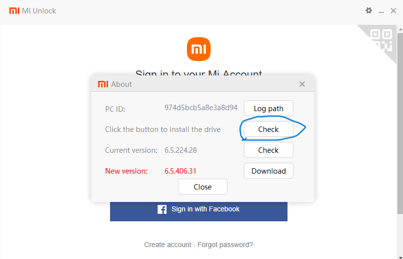

got it! i did this. started the Mi Unlock software, clicked that wheel in the upper right corner and then clicked on "Click the button to install the drive" after that something happend, software did some action and then my cell connected to pc
