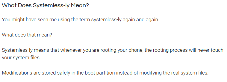

1- I have this issue since a long time ago , where the in-call volume is to low to hear clearly and someone here was talking before that you can edit values in (mixer-path.xml , mixer-path-i2s and mixer-path-tasha) after rooting the phone
but when I do that and edit this files then reboot , I found nothing changed .. also .. I found that the files I edited still the same like i did nothing in them .
I knew now that rooting by Magisk leaves system files untouched (check attached screenshot from Magisk official site) .

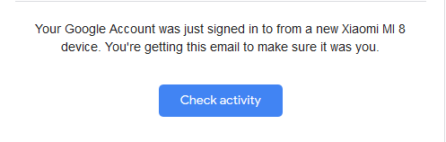

2- I receive this security alerts on my mail whenever I log into my email address from a new device (check second screenshot) , My device is a Mi Max 3 and in the alert says it's Mi 8 which is not my device (and I know for sure that it was me who logged to this email address )
so , can anyone tell me how to solve this problems ?
