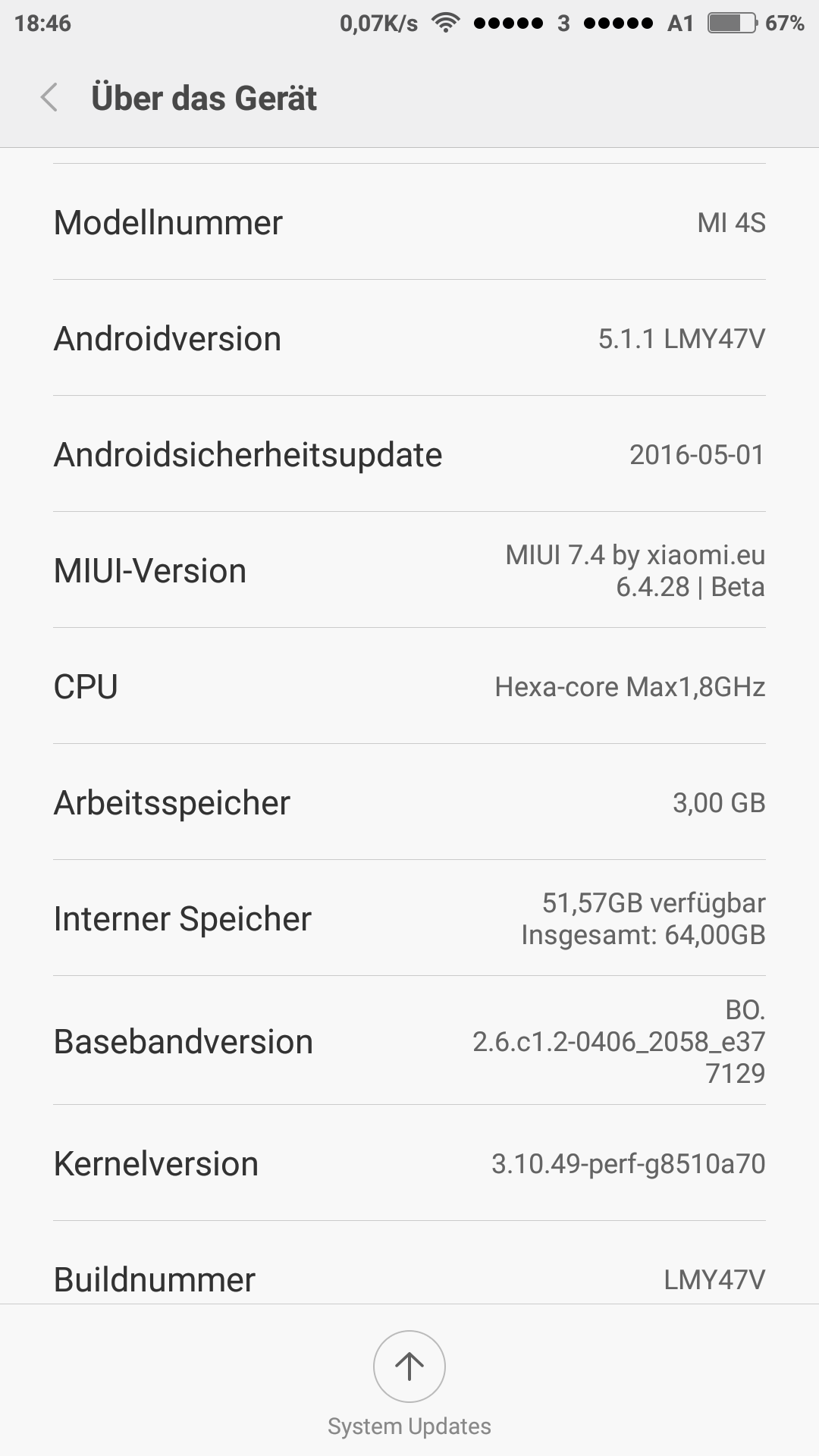

Can you put a screenshot please.
Do you have twrp
Enviado desde mi MI 4S mediante Tapatalk
screenshot enclosed, i think i have twrp, since i did make an update already a long time ago, i used trading shenzhen tutorial

Ok, it's really simple to update, if you want stable ROM of this link,
https://www.androidfilehost.com/?w=files&flid=126103
the last 8.1.4, if you want the developer, the last one I have, from this other link
https://www.androidfilehost.com/?w=files&flid=137906
At the moment there is no more because they are with Android 7.0. If you have twrp and you are going to put miui 8, you have to update the twrp first
https://www.androidfilehost.com/?w=files&flid=50678, aqua v8
and then once updated, put inside the phone the ROM you have chosen, and from the recovery you are going to clean advanced, you do wipe cache / dalvik, system and data , You lose the applications, but it is recommended because you change base. You can make a backup but I recommend you just restore the apps.
You can also use another method, you put the ROM inside the phone, in a folder that you think called Download_rom, then you go to settings, about the phone, and above in the three points click on select package, you look for the ROM and ready
