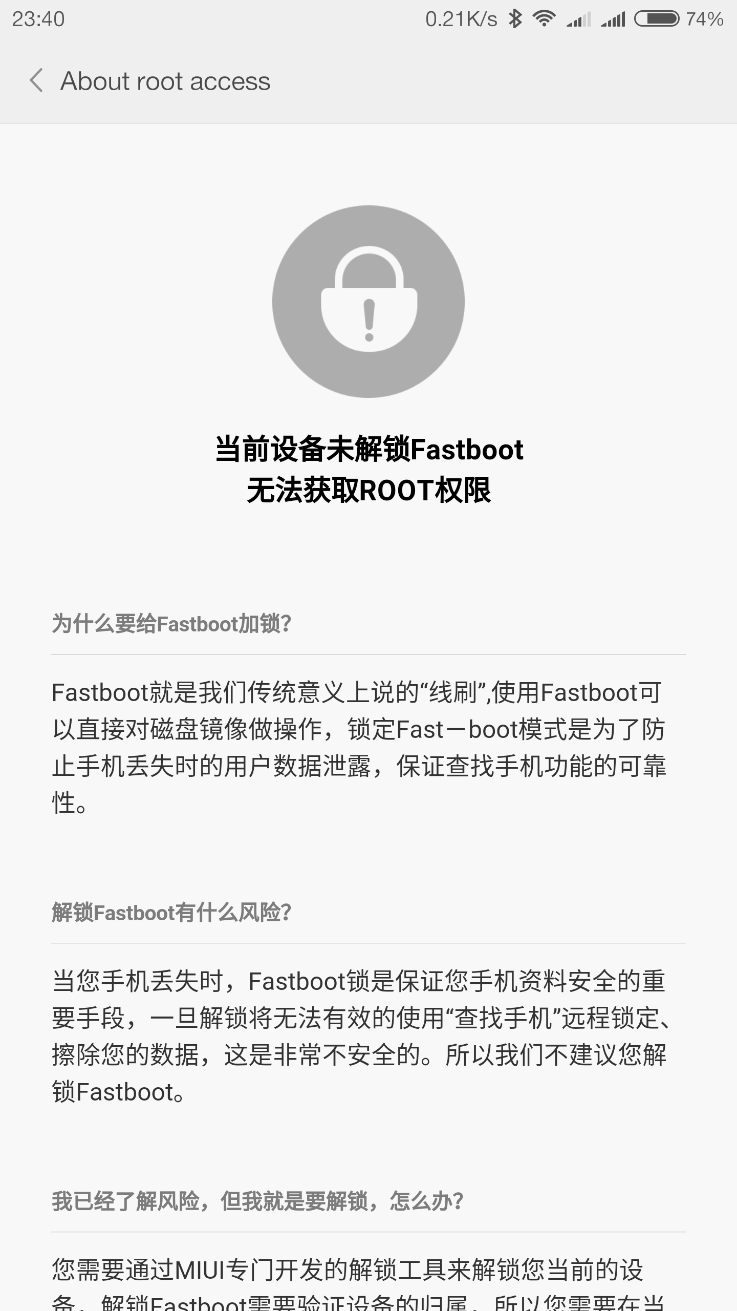

Thanks a lot. Actually the upgrade I've done was made by the MiPCSuite... so I think the firmware now is the original one. The option security is unavailable on my ROM. that's why I had to unlock the boot loader by the MiFlashUnlock... but it doesn't work! :(

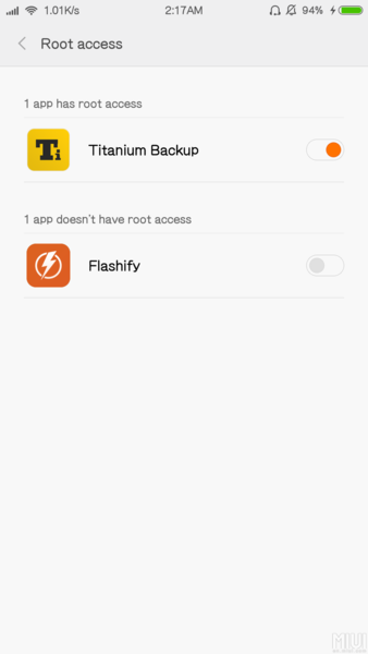

Thx
If you will flash like I showed U will get root access

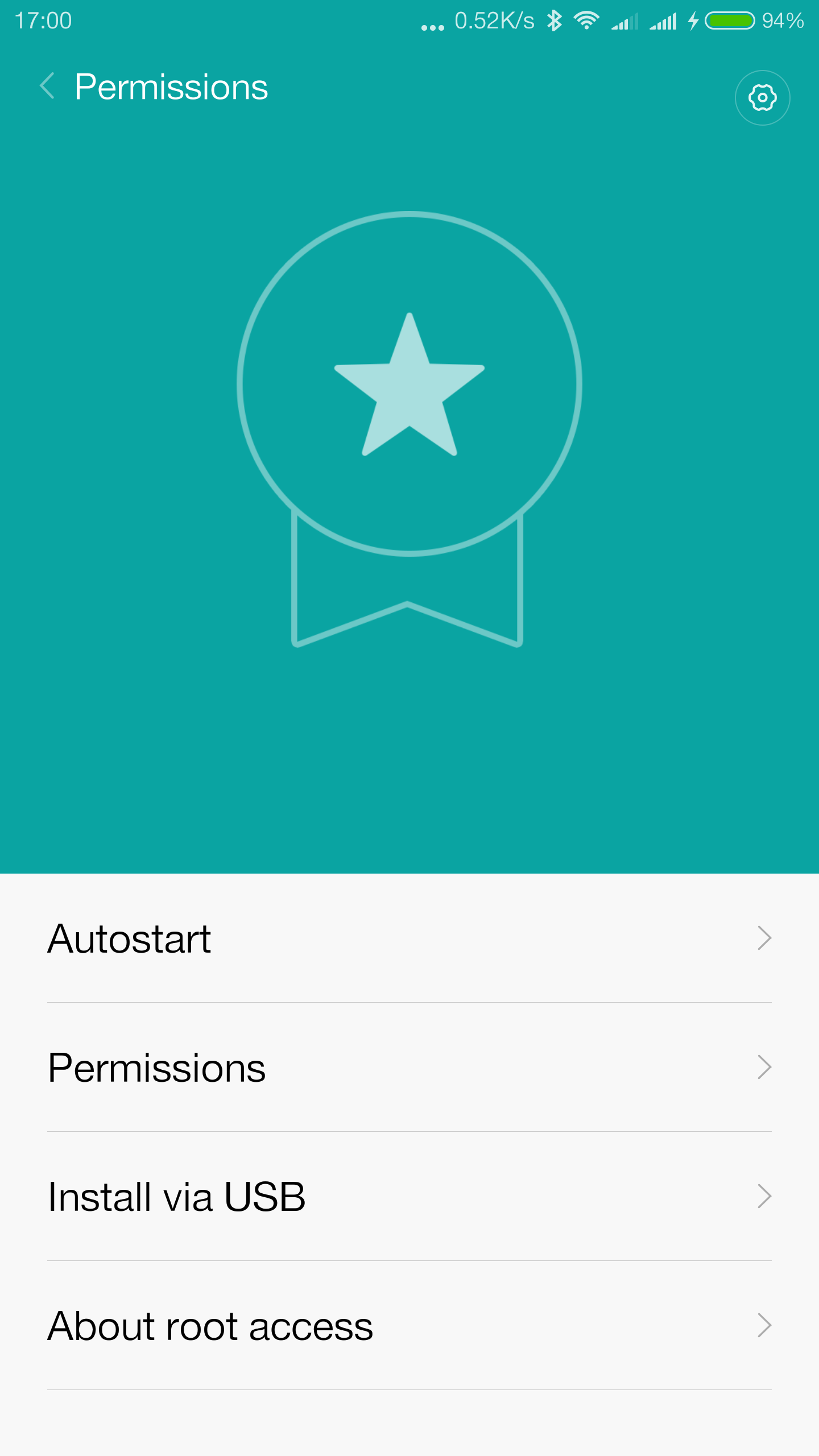

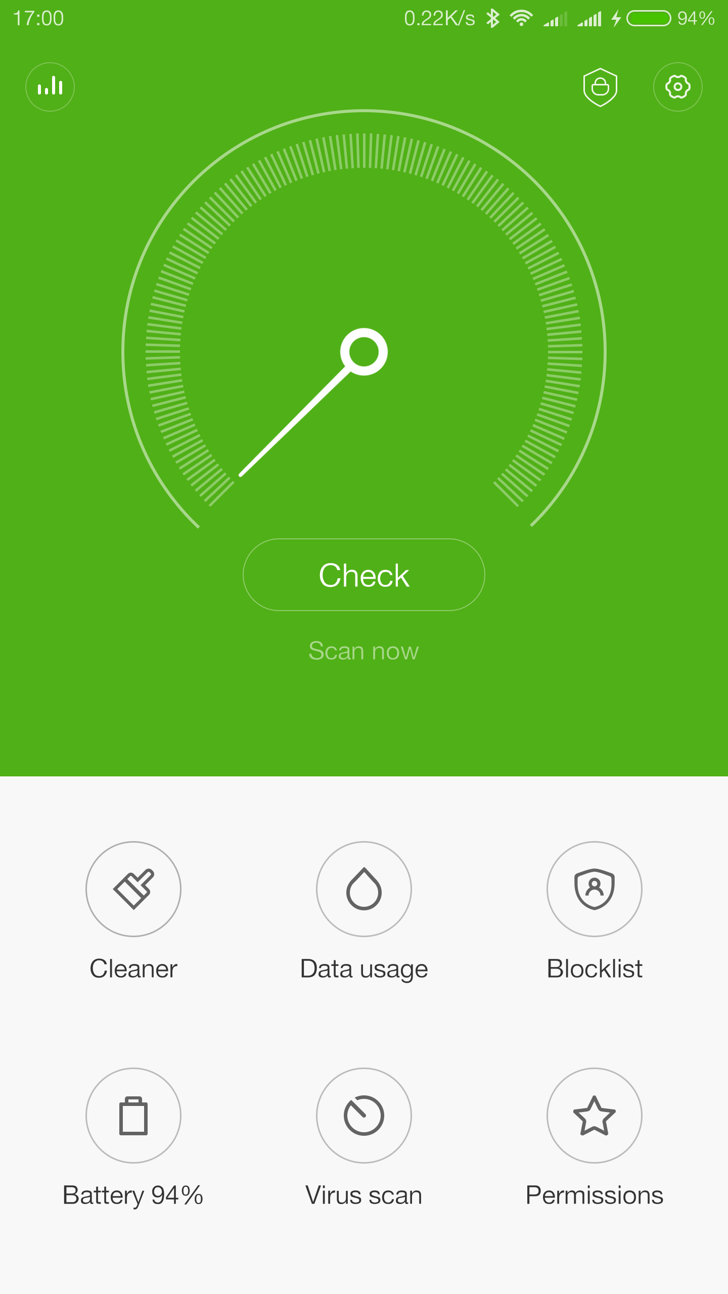

These are the only options available, but no root access for any application is available... ora I'm looking in the wrong place...
