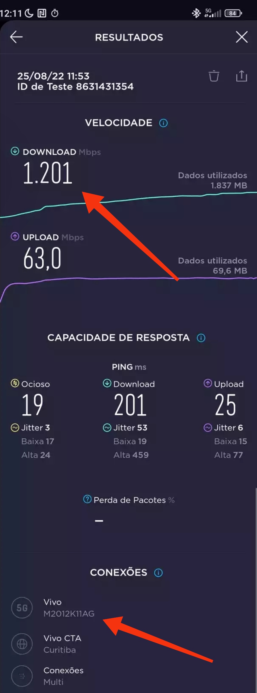

My Poco F3 like yours hasn't n40 but the three main carriers in Brazil (Vivo, TIM and Claro) has 5G NSA/SA over n78 mainly.
Since I'm reach download speeds higher than 1.2Gbps connected just in the n78 who cares if n40 is available or not.
:cool:
