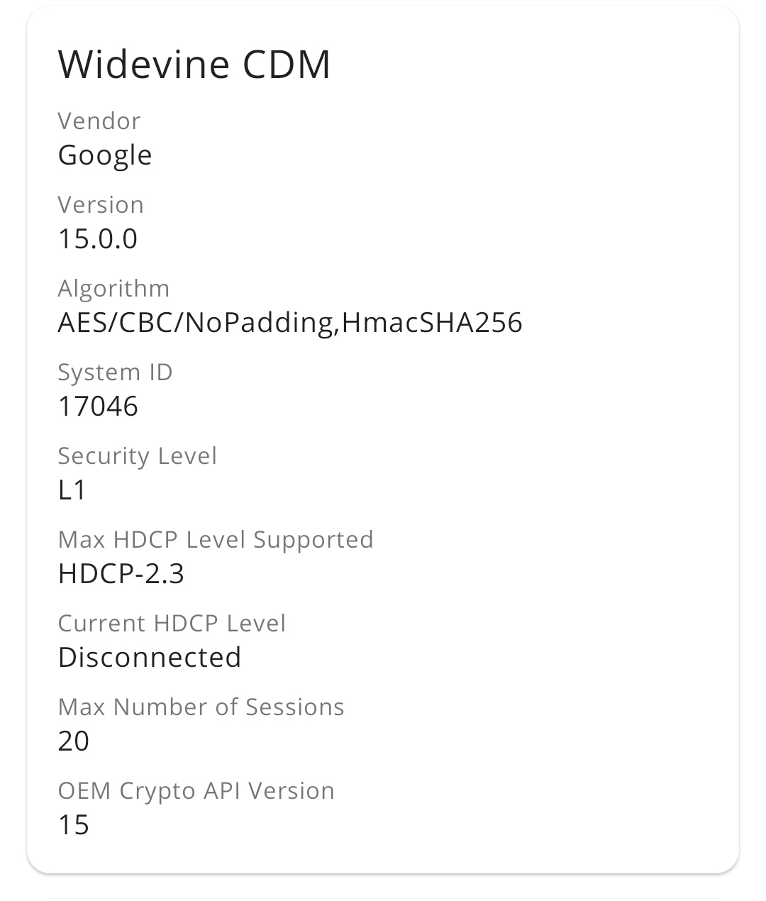

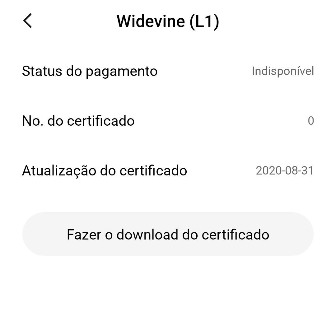

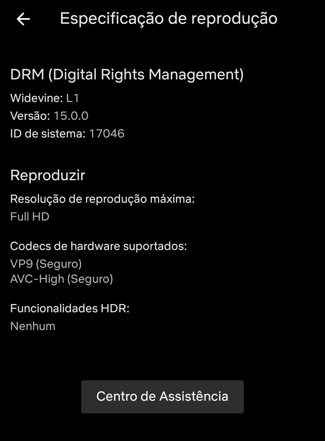

Hello!! Update on this subject.
Managed to restore L1 on my Curtana.
I don't know if it will work for everyone but this is how I've done it.
After trying several roms I did go back to stock ROM.
So I flashed original persist on twrp(in my case only bcz I've messed it before), extracted it from original fastboot EEA. Version 11.0.4 and copied persist.img to sd card. On twrp flash image. After this still L3. If you still have original persist ignore this part.
Used mi flash to flash EEA 11.0.4 and relock bootloader, still L3 at that point.
Gave up trying for a few days at this stage but read a post on mi community of a user saying that he got L1 back on latest Xiaomi.eu. as I prefer .eu tried today to flash it again.
So I downloaded latest Xiaomi.eu 11.0.11 and copied to sd card.
Unlocked bootloader again, flashed twrp 3.4.1-10.0-b5.
On twrp flashed xiaomi.eu and after formatted data bcz I was coming from stock ROM.
After restoring all software the only thing I did different is on the security->fingerprint screen there's a payment option with L1 certificate download option. Did that and now I have L1 again.
Don't know exactly what triggered it, maybe latest rom addressed it, maybe the certificate or got lucky.
Can anyone try it to see if it's isolated solution or if it can help more people?
