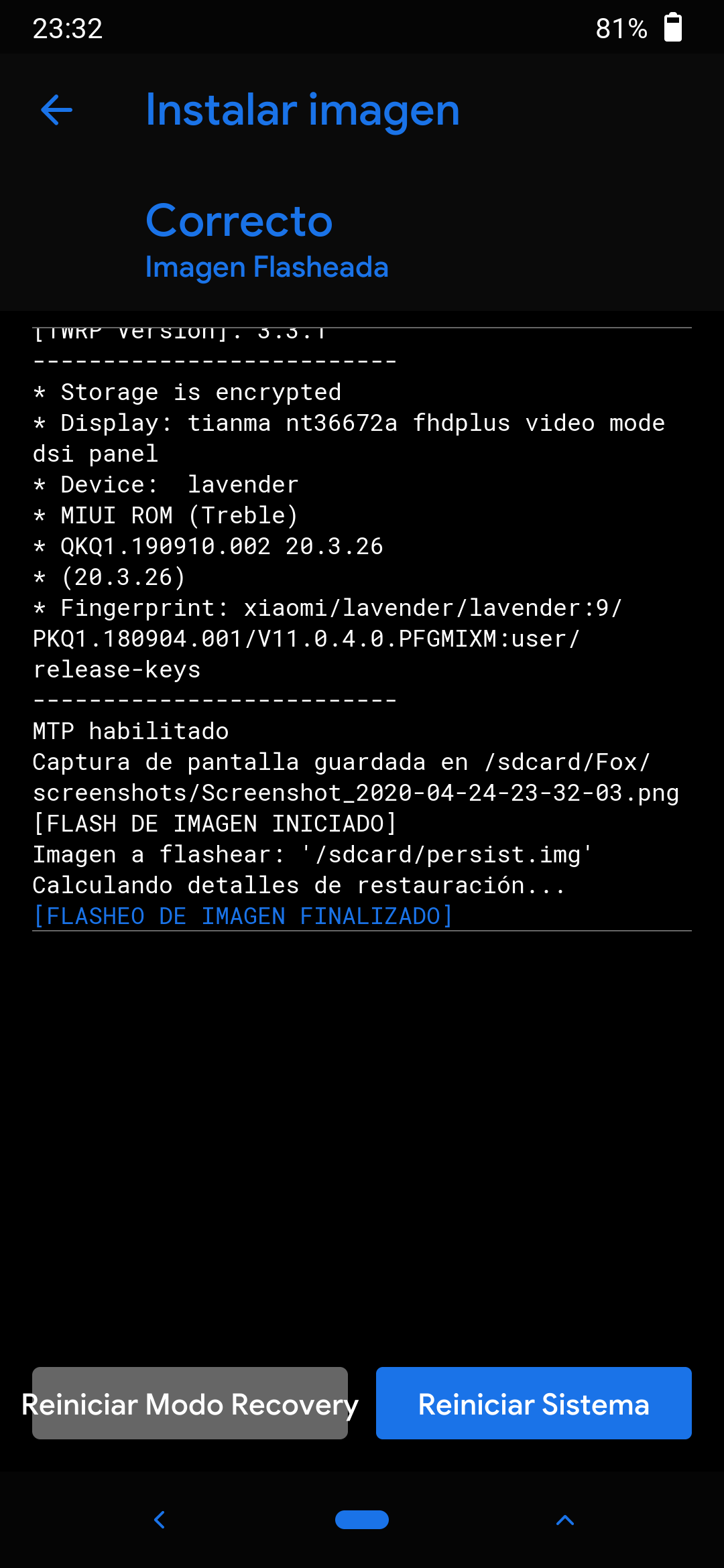

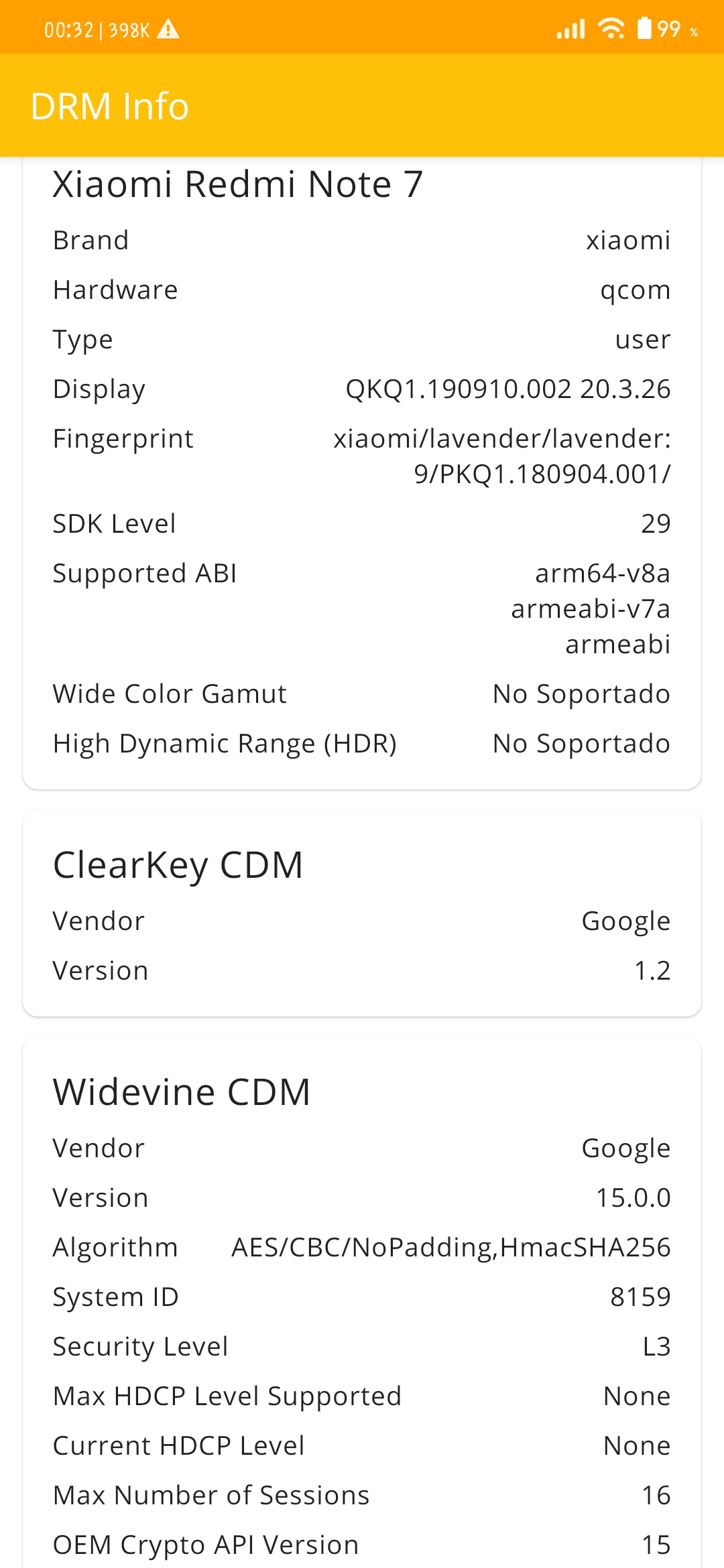

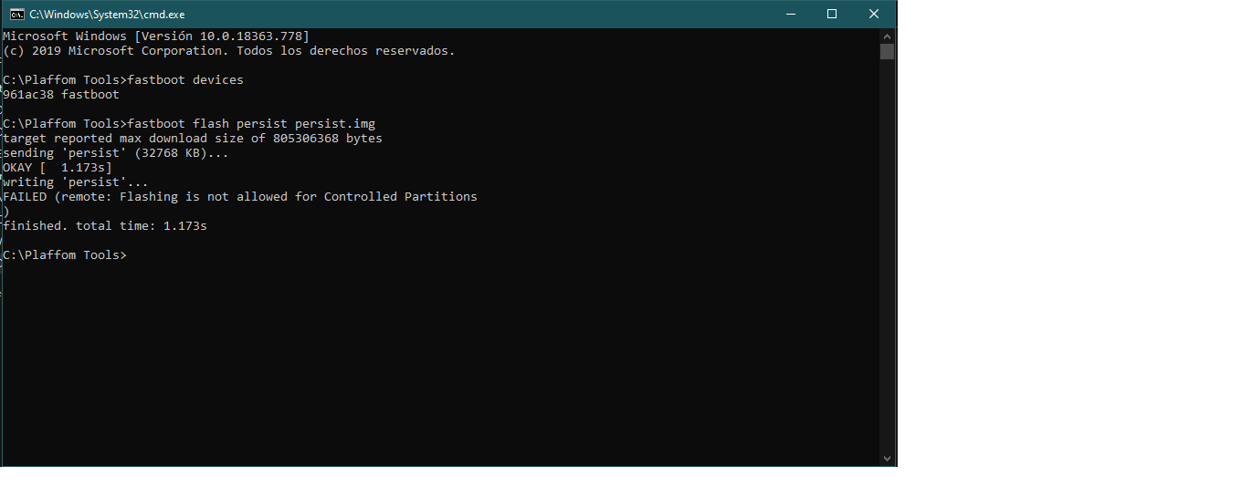

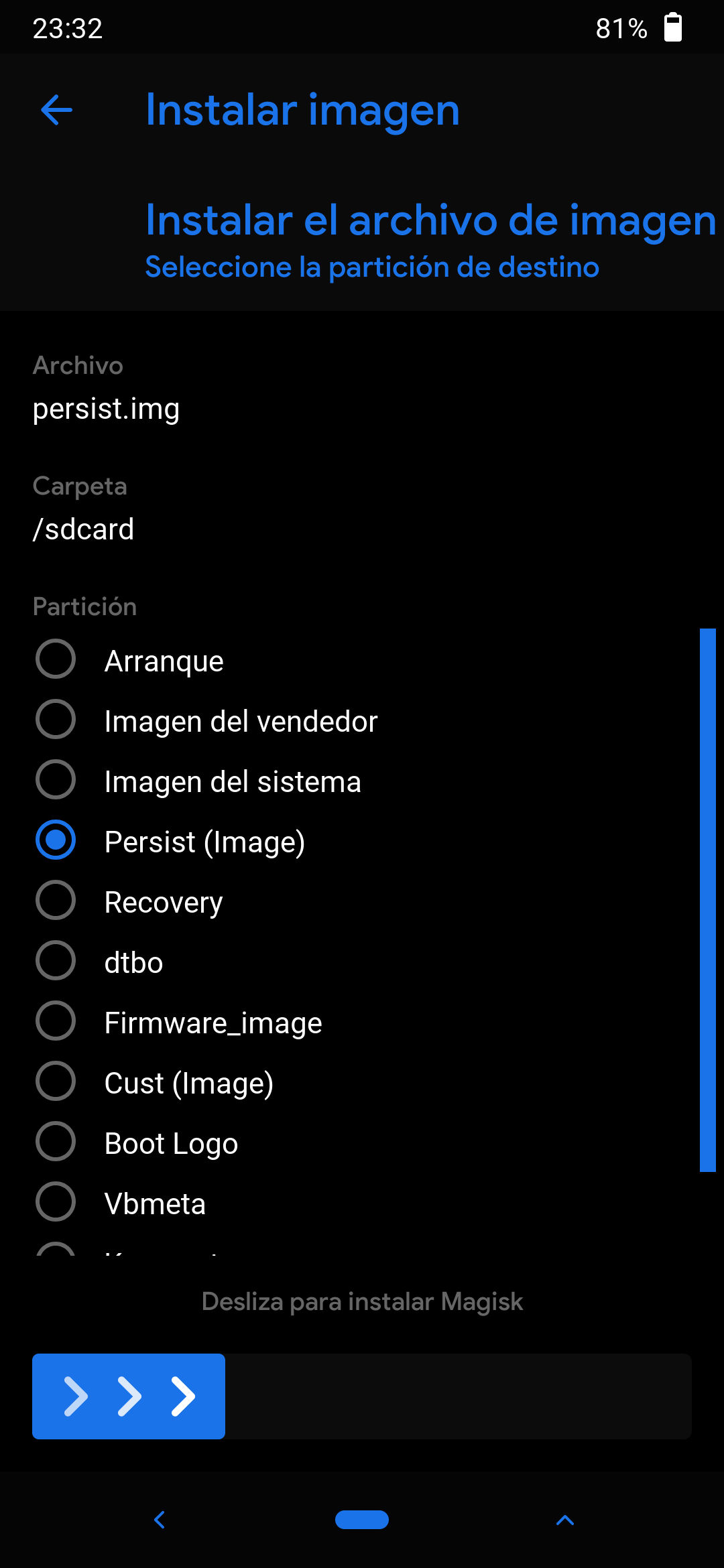

It was a total failure, download the full rom as you told me and flashing Persist.img and I did the 3 steps you gave me.
1-Flashing Persist.img by recovery that was successful
2- Flashing Persist.img by My Flash modifying the files like the video and failure, it gave me an error
3- by ADB and I get an error
Below I will leave images of how the process was and I am returning to Stock to see if the Wifi with bootloader blocking is also solved.

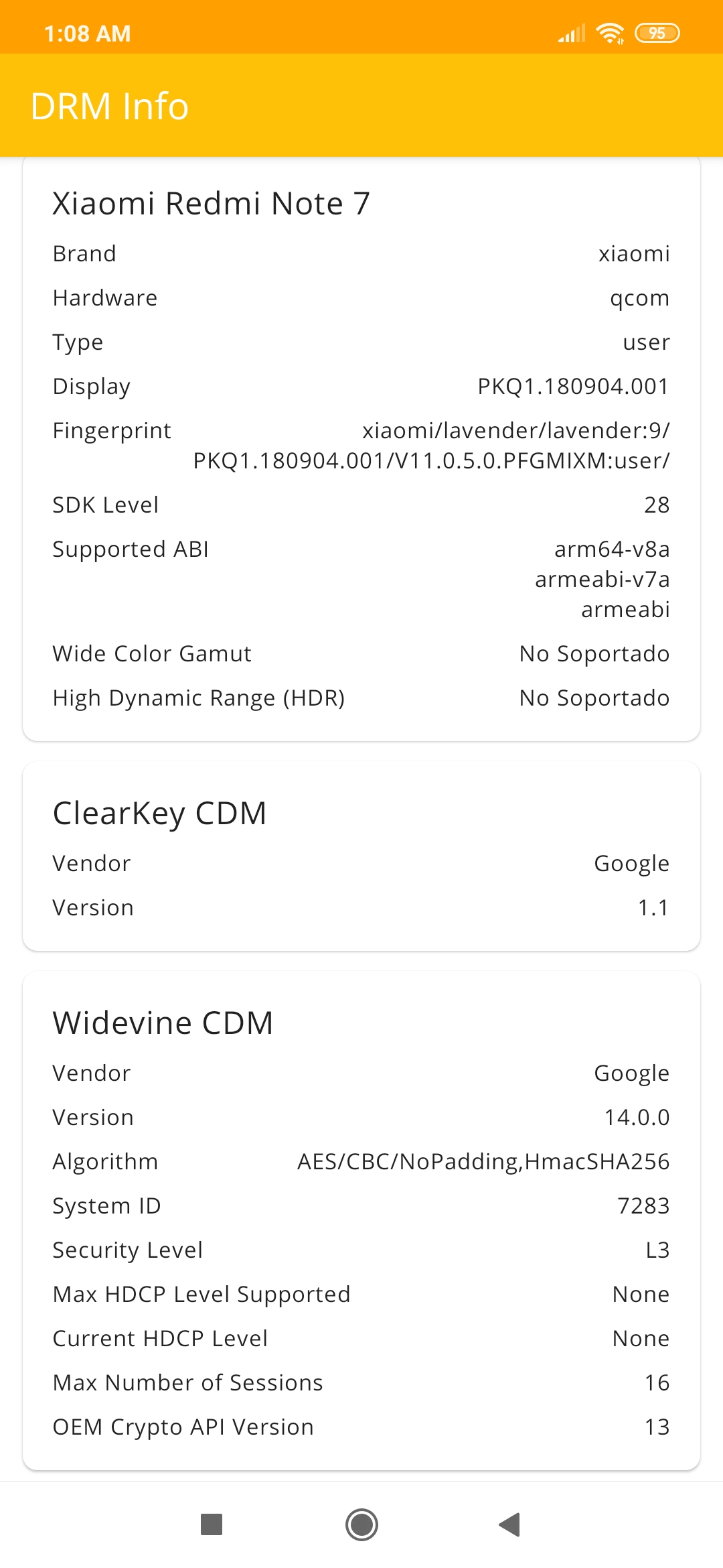

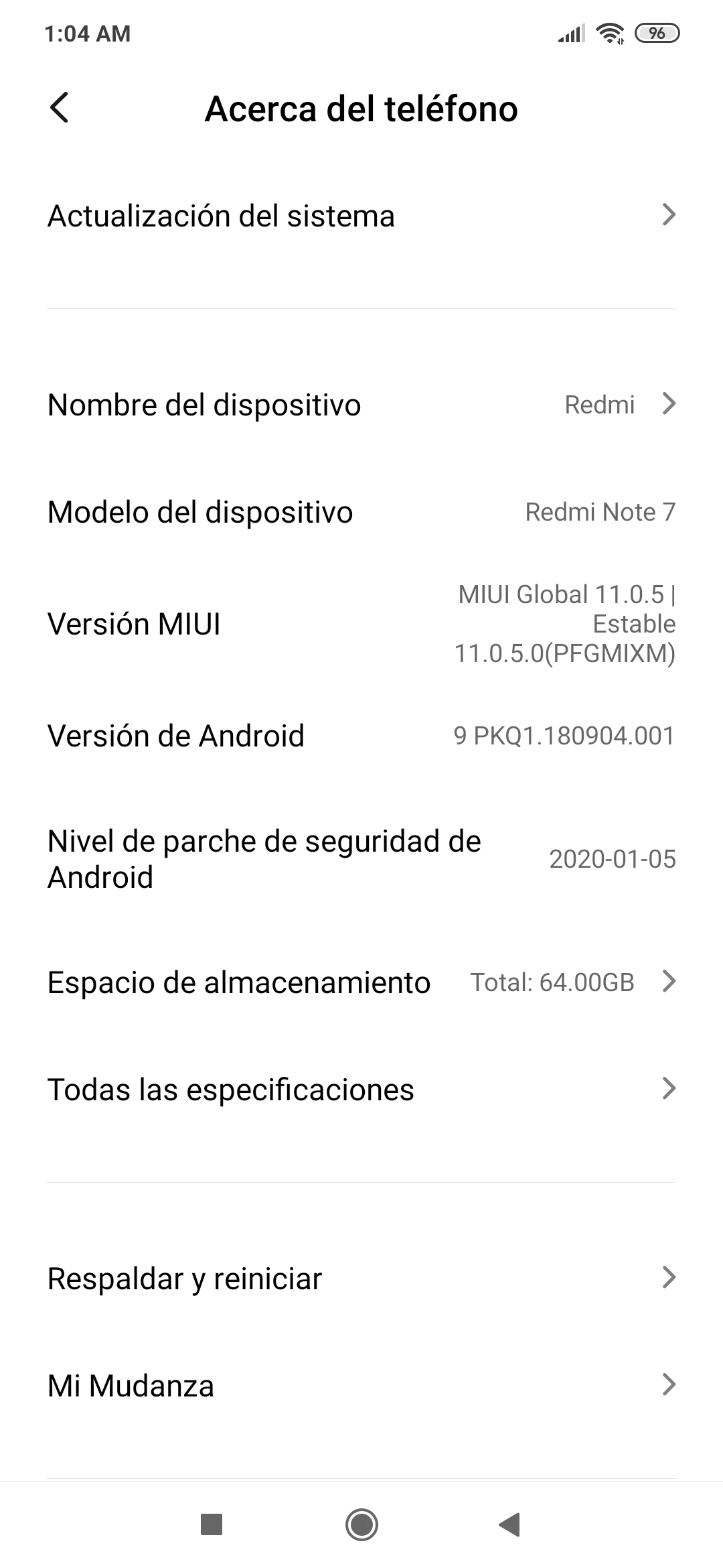

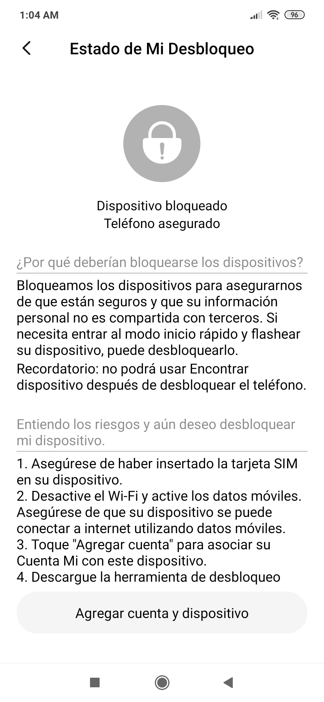

I thought it was the 3 options but it does not matter anymore, I am in Stock and I did not recover the Widevine L1, I am in L3 but the Wifi that was disconnected and connected in this last beta of the EU, was already solved in Stock.

On Xiaomi devices: You lose Widevine L1 if you flash ANY image on "persist" partition, even from a backup you made!
Some people say you can get Widevine L1 back if you flash your own persist image/backup (or not?) then rollback to Android 9 and update to Android 10...
Don't know if it really works. ;)

The problem is that I never made a copy of the original persist that the device brought
But I already solved the Wifi, which was what I wanted, since it disconnected and connected only occasionally in a matter of seconds, I resigned myself to Widevine L1. I tend to settle for L3

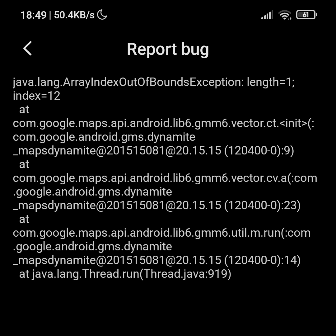

Guys, I'm having a problem with the Running App "Strava". Whenever I try to record an activity, the app crashes and the following error is displayed:
Do you guys know any solution to this? I already tried:
1 - Put the battery option (on background settings) to "No restrictions"
2 - Allowed all the permissions (on the App Permissions settings)
3 - Allowed all the permissions (on the Other Permissions settings)
I really don't know what else I can do, and have no place else to go.
