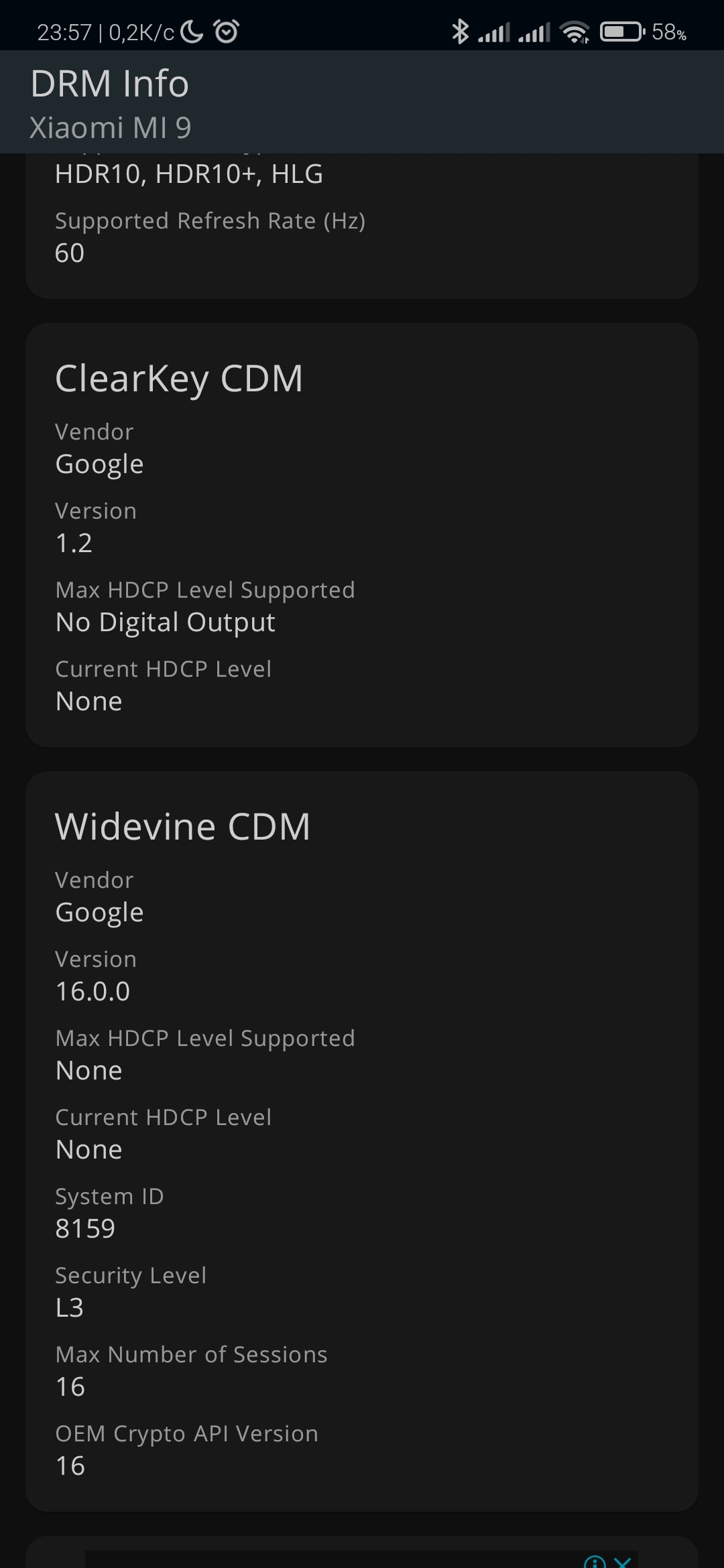

After dirty flashing 21.1.20 on my Mi9 coming from 21.1.14 Widevine security level changed from L1 to L3. Anyone else having this problem?
Seems like Xiaomi removed the L1 libs they added by mistake in the last release of Mi 9...
No worries, we already added them back and we'll reupload the ROMs for cepheus and raphael soon.
As for pyxis and grus, there are no L1 libs for Android 11 yet, we'll have to wait for a Global ROM based on Android 11.

Thanks for the quick fix and the reupload! Widevine back to L1 with latest upload.
After installing the latest firmware (for fix widevine) all the same. maybe there is some problem on my phone with the partition persist? Maybe it needs to be reflashed? from which firmware to take it?

The ROM with the fixed libs is already reuploaded for Raphael?
Because I already re-downloaded the zip from Source Forge (same MD5 from OTA update) and the issue persists

Already reuploaded. Devices which lost their L1 keys before by wiping persist partition, will not get their keys back.
It's not like with devices such as Mi 10 series where you can request a new key...

Well I never wiped my persist partition and with 21.1.14 I had Widevine L1...
I just flashed this new update (21.1.20) and now lost it...
Like I said on my bug report this last update definitely screwed Widevine....
Because even rolling back to 21.1.14 the issue still exists

Maybe, dunno. Some users confirmed that their L1 is back, that's all we can do here...
