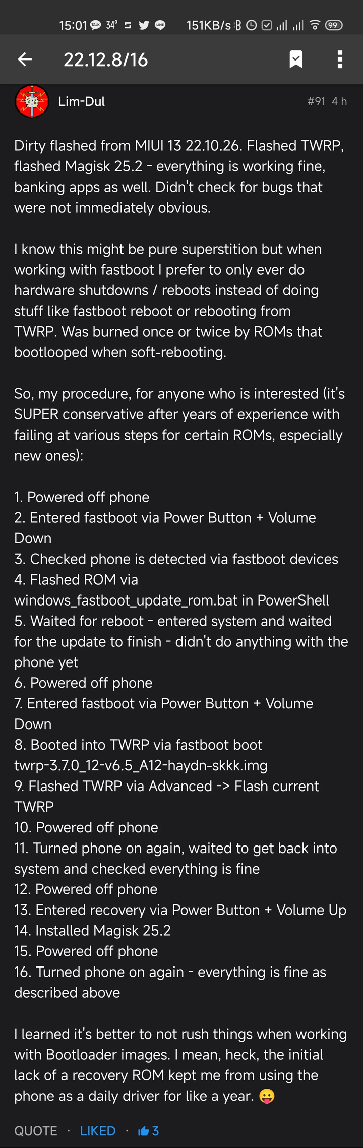

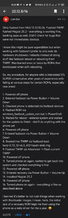

Successful (dirty) flash of the ROM, TWRP and Magisk on my Redmi K40 Pro+. Coming from the previous MIUI 14 Dev ROM.
I'll repost the steps I followed since they seemed to help a few people in previous version's thread.
Merry Christmas to everyone (who is celebrating it)!
My SUPER conservative procedure after years of experience with failing at various steps for certain ROMs, especially new ones:
Optional pre-step for dirty flashing:
Delete / move all scripts apart from the "XXXX_fastboot_update_rom.xxx" script for yor OS from the extracted ROM directory to avoid costly mistakes.
  1. Powered off phone completely
  2. Entered fastboot via Power Button + Volume Down
  3. Checked phone is detected with
    Code:
    fastboot devices
  4. Flashed ROM via PowerShell with
    Code:
    .\windows_fastboot_update_rom.bat
  5. Waited for reboot - entered system and waited for the update to finish - didn't do anything with the phone yet
  6. Powered off phone completely
  7. Entered fastboot via Power Button + Volume Down
  8. Booted into TWRP with
    Code:
    fastboot boot twrp-3.7.0_12-v6.5_A12-haydn-skkk.img
  9. Flashed TWRP via Advanced -> Flash current TWRP
  10. Powered off phone completely
  11. Turned phone on again, waited to get back into system and checked everything is fine
    --- STOP HERE IF YOU DON'T WANT/NEED ROOT ---
  12. Powered off phone completely
  13. Entered recovery via Power Button + Volume Up
  14. Installed Magisk-v25.2.apk via TWRP (changed the extension from .apk to .zip, resulting in Magisk-v25.2.zip)
  15. Powered off phone completely
  16. Turned phone on again

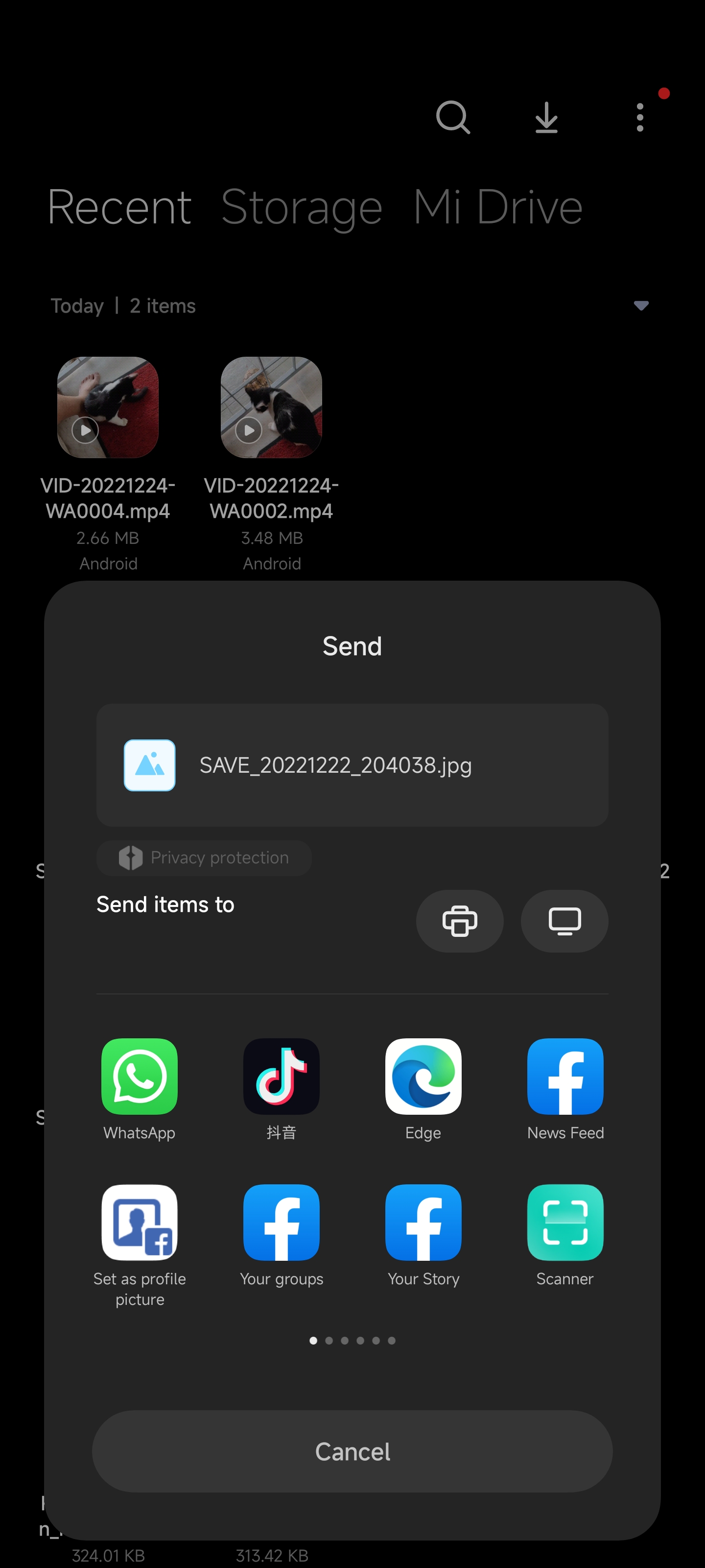

Mi share not functioning ? Anyone also having the same issue ?

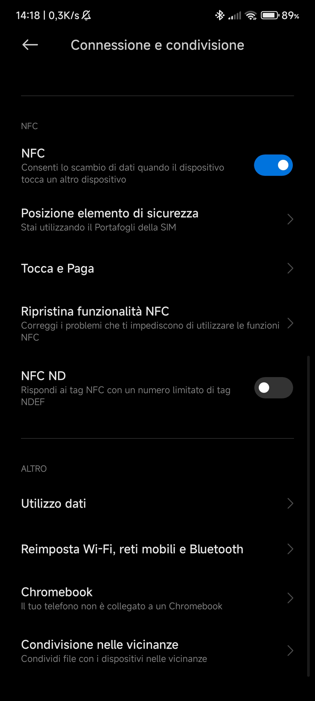

NFC payments doesn't work at the moment in POCO F3. I have tried everything to solve it, but it's impossible. I have changed the HCE wallet option too, but it doesn't work.
Any problem here. Did you set a lockscreen pattern?
Try to reset NFC from the settings page (Ripristina funzionalità NFC in Italian) and search for NFC app permissions in apps.
Android 13 has a lot of new permissions that may have not been set while updating from 12 (this if you didn't made a fresh installation)

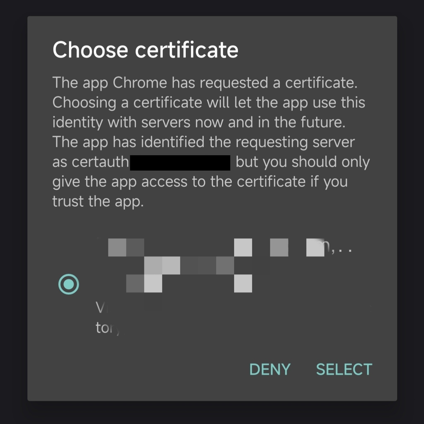

Hi Team,
I had this issue with the first beta...updated it today but still my work profile is having issues.
The service has managed to install successfully.
However, whenever I try to launch MS Teams, MS Outlook, OneDrive etc., the app launches but hangs.
It is supposed to come up with the certificate selection but that option is not coming. see sample below.
I have attached the link for logcat as well. Appreciate if anyone would be able to assist.
https://mega.nz/file/ctEhBbDC#Tqt3NqOJ_v4xoWK8qiurhld2nlcF6az6eNehKe9qw2o
Thank you very much in advance.
Hoping to get some response this time...
If not, I'll go back to MIUI 13 while waiting for some fix to come along..
Any advise @ingbrzy or @Igor Eisberg ?
Someone has posted on the bug section as well but not much help there.. hopefully the developer can advise?
