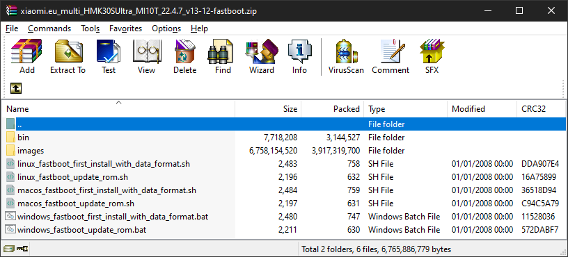

hello, in the new firmware 22.4.7 for mi10t pro apollo no items
"* update_rom (without formatting data), if you're moving from Android 11 xiaomi.eu ROM.
* first_install_with_data_format (with format data), if you're flashing xiaomi.eu ROM for the first time."
how to update? Thank you
There are. Extract the ZIP properly.
Reactions: biscoot
I zip in myself, but these items are not there. Before that, I did 5-6 firmware so everything was fine, this one is not. how to do it right?
You might wanna check in with the eye doctor then.

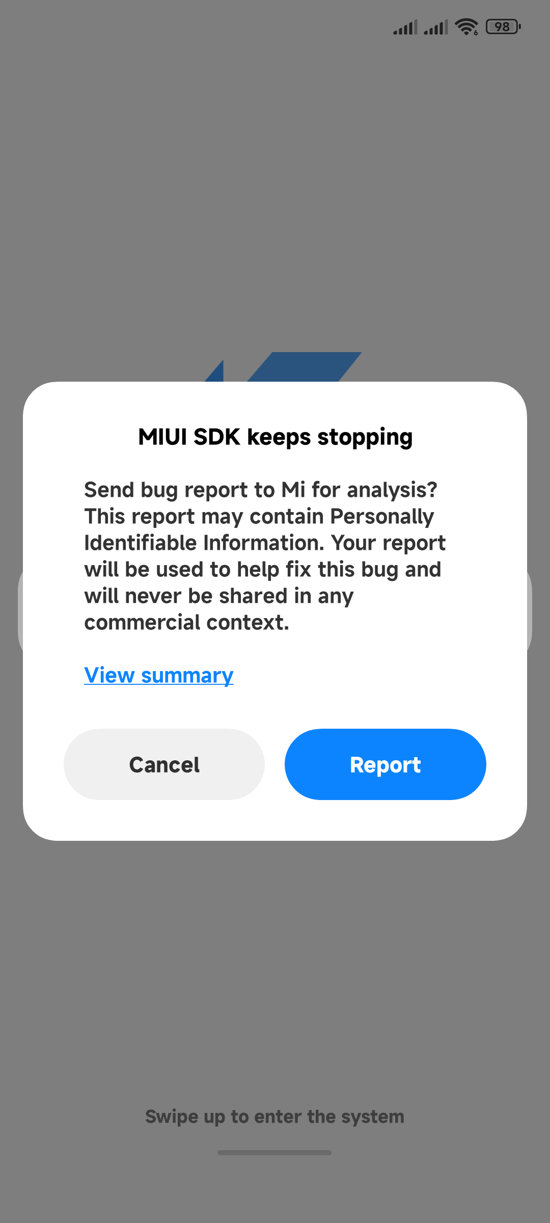

Mi 11 Pro, MIUI SDK keeps stopping after setup. Here's the log:

java.lang.RuntimeException: Unable to start service miui.autoinstall.config.service.LocalInstallService@2e41194 with Intent { act=miui.autoinstall.config.action.LOCALINSTALL pkg=com.miui.core }: java.lang.SecurityException: Provider com.miui.core/miui.autoinstall.config.LocalInstallProvider does not allow granting of Uri permissions (uri content://com.miui.core.localinstall.status [user 0])
 at android.app.ActivityThread.handleServiceArgs(Unknown Source:146)
 at android.app.ActivityThread.access$2100(Unknown Source:0)
 at android.app.ActivityThread$H.handleMessage(Unknown Source:671)
 at android.os.Looper.loopOnce(Unknown Source:176)
 at android.os.Looper.loop(Unknown Source:76)
 at android.app.ActivityThread.main(Unknown Source:153)
 at com.android.internal.os.ZygoteInit.main(Unknown Source:309)
Caused by: java.lang.SecurityException: Provider com.miui.core/miui.autoinstall.config.LocalInstallProvider does not allow granting of Uri permissions (uri content://com.miui.core.localinstall.status [user 0])
 at android.os.Parcel.createExceptionOrNull(Unknown Source:7)
 at android.os.Parcel.createException(Unknown Source:0)
 at android.os.Parcel.readException(Unknown Source:11)
 at android.os.Parcel.readException(Unknown Source:10)
 at android.app.IActivityManager$Stub$Proxy.grantUriPermission(Unknown Source:82)
 at android.app.ContextImpl.grantUriPermission(Unknown Source:20)
 at android.content.ContextWrapper.grantUriPermission(Unknown Source:2)
 at miui.autoinstall.config.service.LocalInstallService.r(Unknown Source:24)
 at miui.autoinstall.config.service.LocalInstallService.q(Unknown Source:6)
 at miui.autoinstall.config.service.LocalInstallService.startInstall(Unknown Source:30)
 at miui.autoinstall.config.service.LocalInstallService.onStartCommand(Unknown Source:90)
 at android.app.ActivityThread.handleServiceArgs(Unknown Source:60)
 ... 9 more
Caused by: android.os.RemoteException: Remote stack trace:
 at com.android.server.uri.UriGrantsManagerService.checkGrantUriPermissionUnlocked(Unknown Source:528)
 at com.android.server.uri.UriGrantsManagerService.checkGrantUriPermissionFromIntentUnlocked(Unknown Source:81)
 at com.android.server.uri.UriGrantsManagerService.access$1000(Unknown Source:0)
 at com.android.server.uri.UriGrantsManagerService$LocalService.checkGrantUriPermissionFromIntent(Unknown Source:16)
 at com.android.server.am.ActivityManagerService.grantUriPermission(Unknown Source:48)
