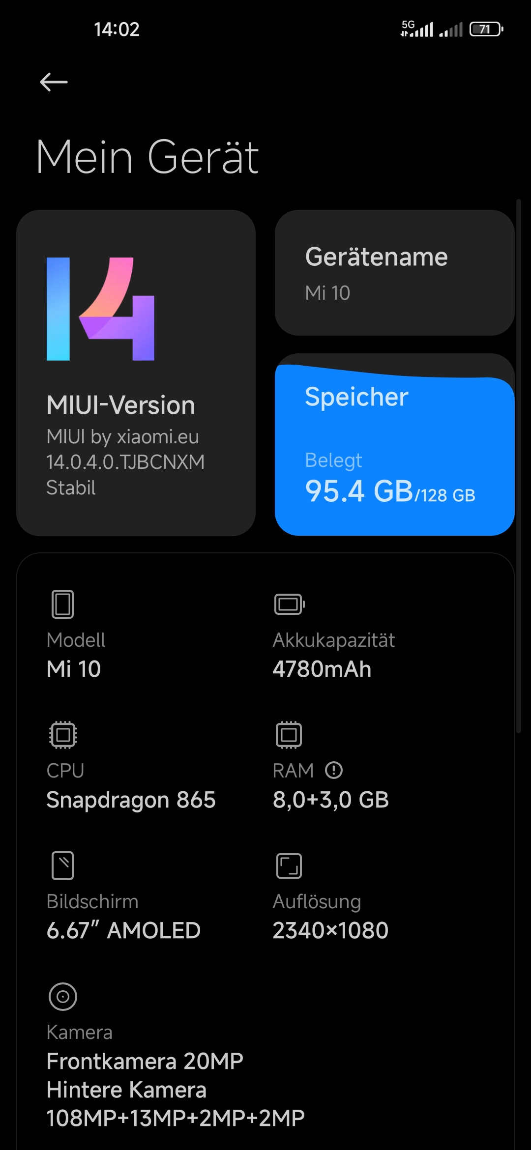

Hello all,
I am now Back in Austria....
I use the Standard Mi 10 Umi!
In Slovenia and Germany i get 5G Networks!
Back in Austria only 2G 3G 4G!
I have two Sim Cards one Spusu (mvno of 3AT) and A1 (the Most Common Provider)
With both Sim Cards No 5G in Austria
I have a second Phone Mi11 Lite 5G with Stock Rom 14.0.8 also No 5G in Austria.

I fixed the Problem now....
It's not a software Bug! It's a provider setting!
For me it works now perfect with gpay and 5G
Maybe there was a hack in the old version because for my second Sim card the Provider told me that I have no 5g access.
I had 5G with this sim card before the update.

Sorry for the delay!
I called the Provider and they told me first it should work... I discussed them and told them they should check this clearly!
Two days later I get a call and they told there was something wrong on there side...
5min later I had 5G.
So if your plan includes 5G and you see in the phone settings nr status restricted it's not the fault of the phone or software. The provider blocked it!
I think before the update there was a hidden hack that ignore restrictions of the provider!
I had 5G with "Spusu" (MVNO in Austria) before they offered it.
