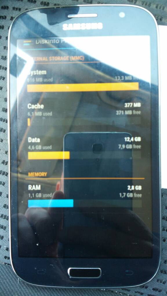

install this app in settings tick all and share screenshot
Here :)
Enviado desde mi MI 4W mediante Tapatalk
