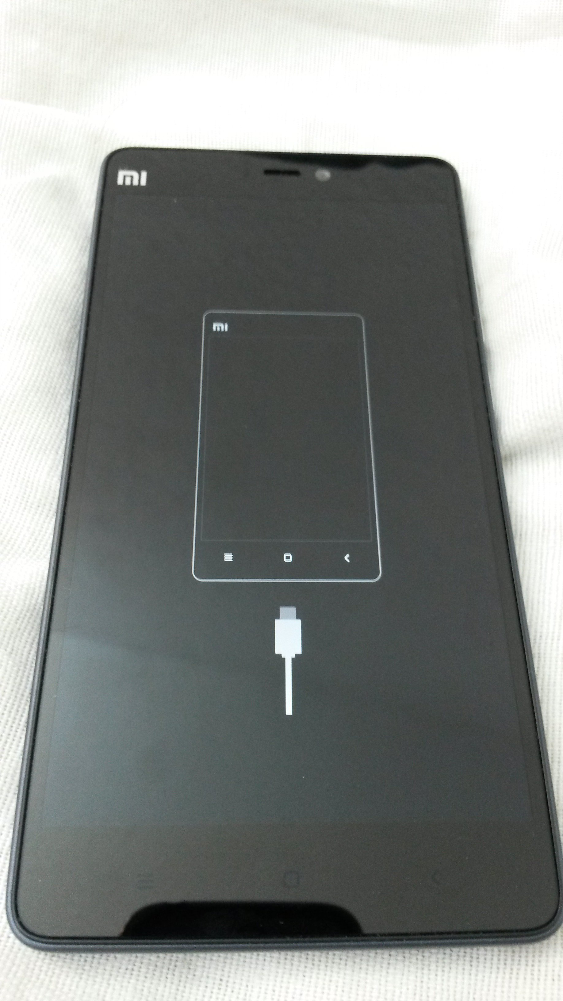

I have successfully unlocked my bootloader (MI4C, libra) and flashed twrp.img via fastboot (updater can't verify update). Then I restarted into recovery but there is no twrp nor default recovery ...
So what is wrong here?
Here is a picture in recovery:
That picture means that the bootloader is locked, try to flash the twrp and tell me what the command line tells you.
I suggest you the same that was suggested to me: "Try with TWRP 2.8.7.0." You have to downgrade the recovery.
I'll be able to do it in the evening, because I don't have access to my pc now.
I confirm to MI4W users that downgrading to TWRP 2.8.7.0 and than updating to 6.3.24 is ok.
At the beginning of the update the error "mount: failed to mount /dev/block/platform/msm_sdcc.1/by-name/userdata at /data: Device or resource busy" is still present; wait some minutes and the update will be successfully completed .

Thanks, its working TE="manurosso87, post: 282359, member: 127170"]I suggest you the same that was suggested to me: "Try with TWRP 2.8.7.0." You have to downgrade the recovery.
I'll be able to do it in the evening, because I don't have access to my pc now.[/QUOTE]
Maybe this post of a guy who faced your same problem could be helpful.
