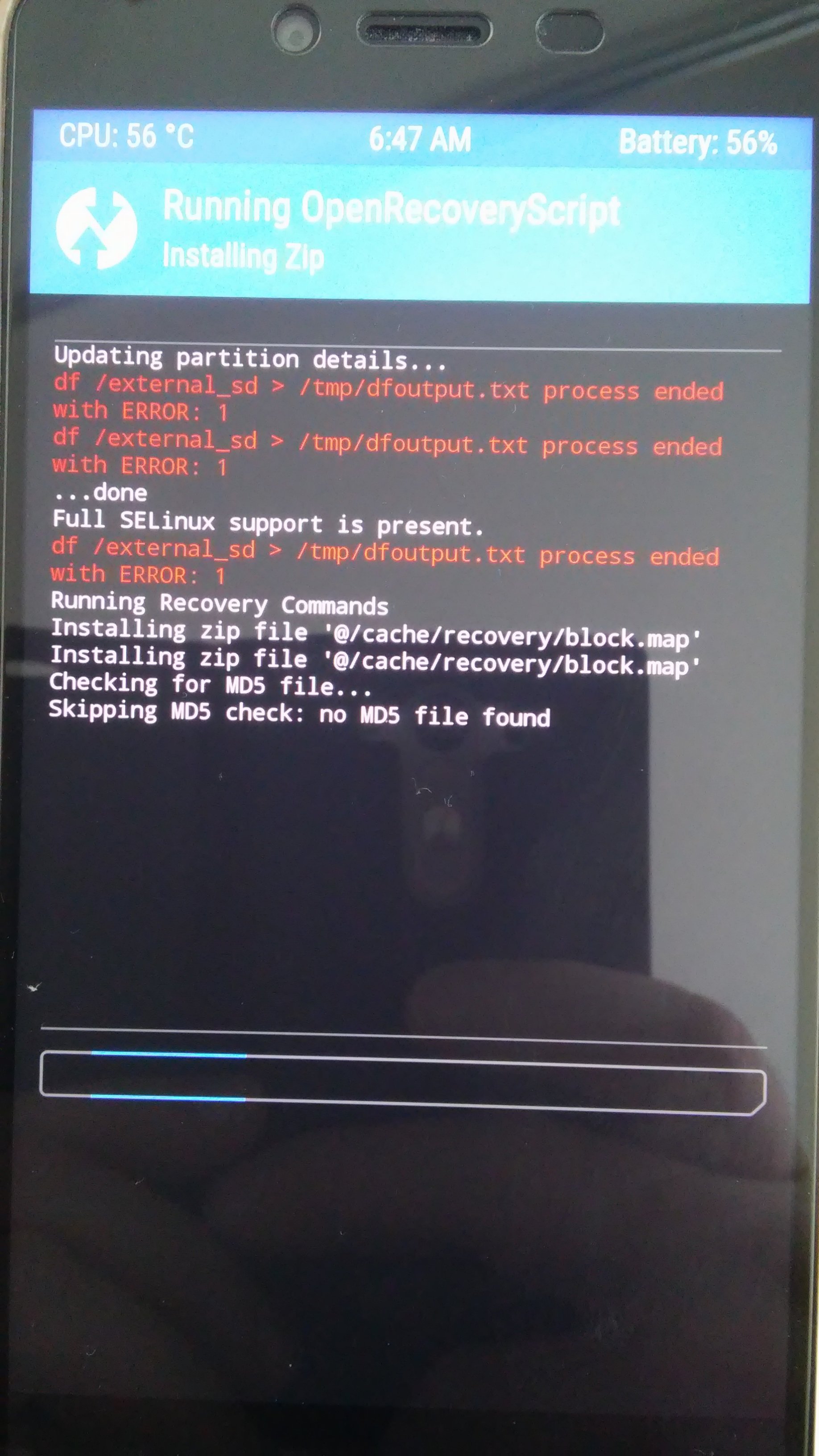

While updating from updater app, I had this errors:
Do I need to worry?
I have a 64GB SanDisk MicroSDXC card (Fat32 formatted) always worked, but now the phone can't see it anymore apparently?!?!?
