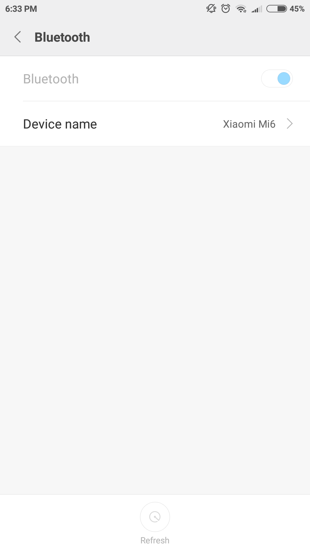

Mi6
BT doesn't work.
It's a pity because i cant use my Mi band and handsfree in car
