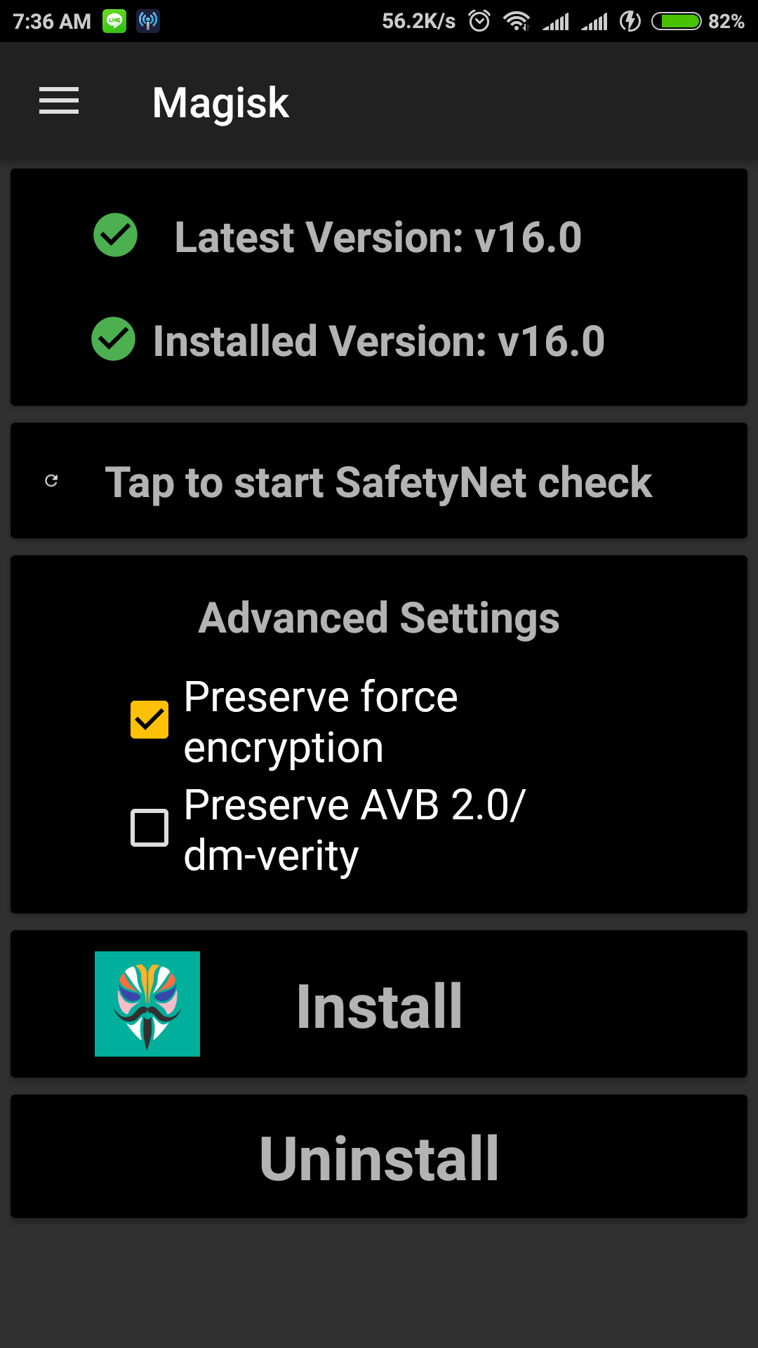

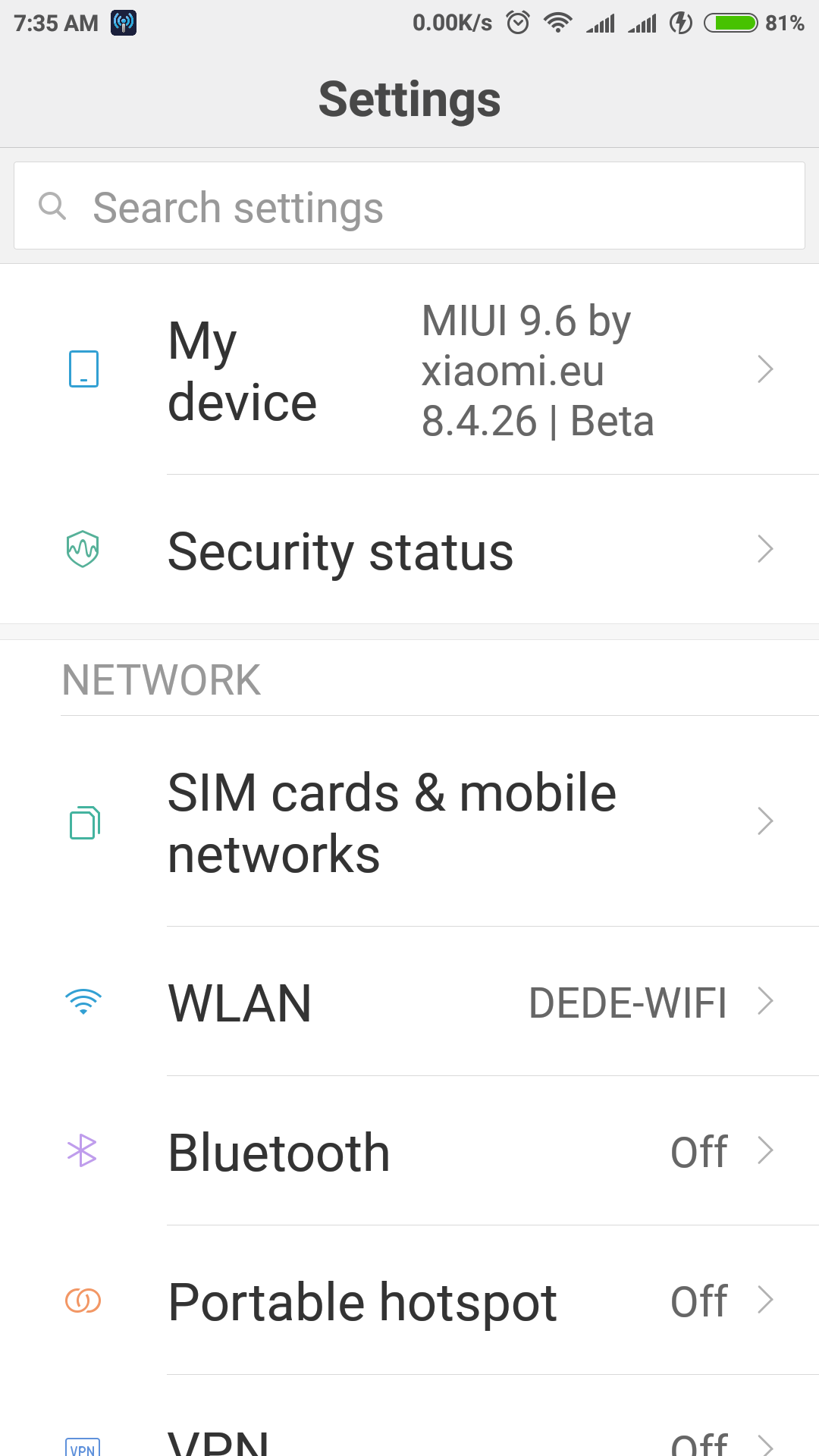

İ use translate and i known little english.u use mi mix i use mi 6.u talk about 8.4.12 i talk about 8.4.26.everything is different.i install now magisk v16.4 zip 8.4.4 and working.my question is for 8.4.26 eu beta weekly
İ install 8.4.26 eu beta weekly my mi6 and i flash magisk v16.4 but problem is same.i stay bootloop
You need uninstall every installed modules before update the SO. I jumped from 8.3.29 to 8.4.26 and it was necessary full wipe to avoid bootloop. You need have certainly if the cause of the issue is the magisk's modules.
Enviado de meu MI 6 usando o Tapatalk
Thank you a will try
Edit:Thank you so much.i uninstall modul and flash v16.4 magisk zip.it work now.
