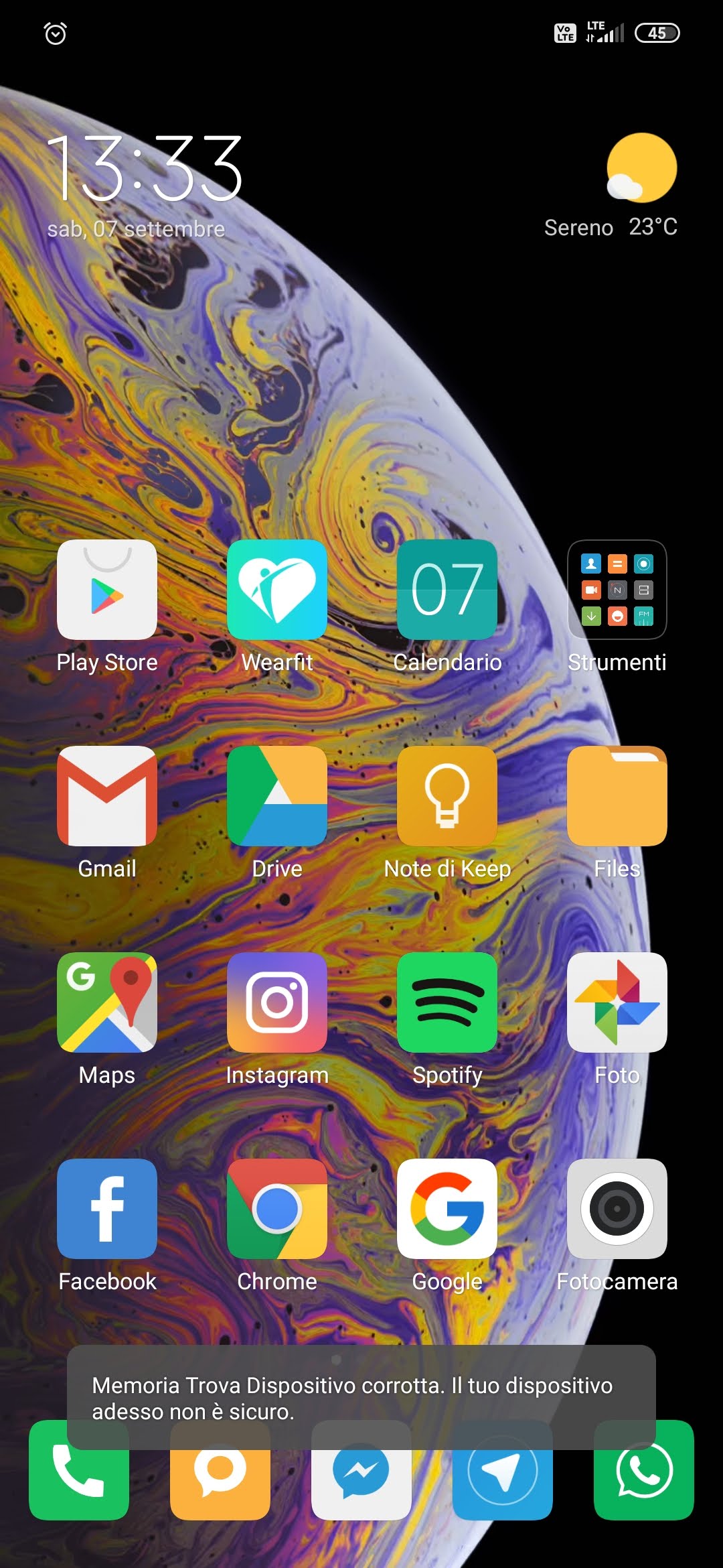

Since some releases when I turn on data and/or wifi a message pops up (see screenshot). Is written in italian, in english it should be "Find my device memory corrupted. Your device is now unsafe". Can't find a reason for this message, it's since august that I read this notif, in july and months before all was good. Can you help me, please?

I think the only change is that the security patch has been updated from 2019-09-01 to 2019-09-05, you could wait a couple of days for a new version to come out, but it is something that is fine to have up to date

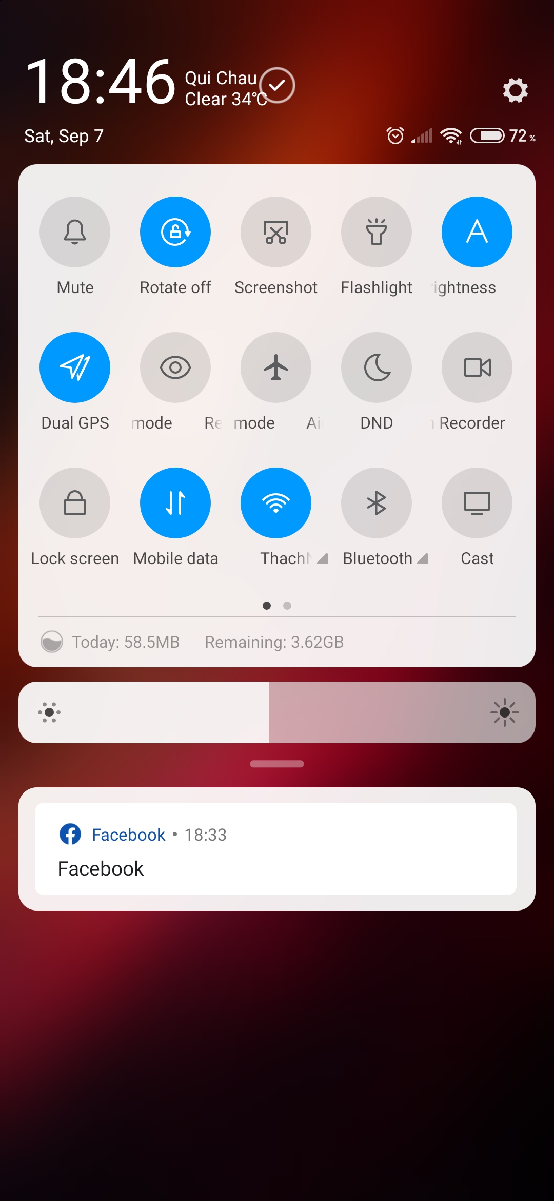

My Mi9, version 9.9.6, I have this problem: Facebook notifications look like bug, i try go to Developer settings - Minimal width - set 380 but this is don't work for me
Same phone and same language, but I've never seen this message before. Does the "Find my device" actually works? If not, I think that a clean install (format data + full wipe + install) is what you need since the error says that it's a memory issue
Yes, they work! Google's one and Xiaomi's one both are working well, they can find my phone.
@devs: can you tell me more about this issue, if you know something, obviously?
EDIT: when I go to i.mi.com (both on mobile and desktop) and trying to locate my device, the phone is located correctly but that message pops out again. I'm thinking about that maybe is an encryption-related issue, how can I discover if my device is encrypted?
EDIT 2: alright, I've got a solution (at least I hope so): I need to reflash the original MIUI from fastboot. That message comes out for some reason if your persist.img is broken and flashing original MIUI should fix this thing ^^
